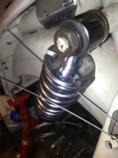

http://tv175.wordpress.com/2012/11/14/e ... ear-shock/
Now finally after 2 broken engine bolts the engine is back into the frame!
I've also added a escort shock. I have one on the other Lambretta and it works quite ok considering price and performance!
