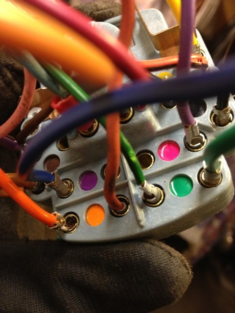

Loom and cables time! http://tv175.wordpress.com/2012/10/22/loom/ I'm not an electrics guy. Hope to have connected these right :)
