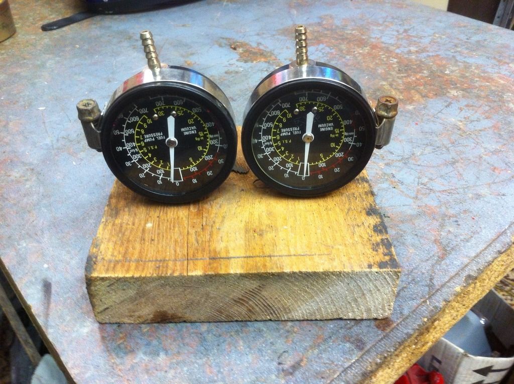

i had ordered some new jets as the ones in were far too rich, stripped the carbs off only to find them full of crap, looks like i didnt clean out my tank properly, so i drained the tank, when i took the banjo bolt out the pipe snapped of the union, must have been cheap indian rubbish, that cheap pot metal they make toy cars out of, so i will go shopping tomorrow and see if i can buy a steel union to replace it with. i have also had an idea how to make my clutch lighter, i am going to extend the length of the internal cluch arm so it has more leverage hoping that will make the handlebar clutch lever easier to pull in, so i havnt been able to use my guages to balance the carbs yet.

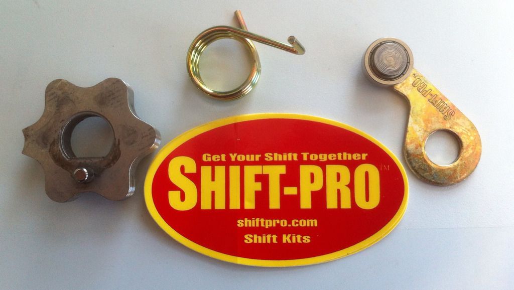

its a little modification brought to my attention by stampede (cheers) its a way to make the gearchange lighter, i was finding it very hard to change gear, obviously in the yamaha my engine came out of you would change gear with your foot, but my handchange cant generate as much pressure so hoping this mod helps. also found that the gear selecter was not adjusted correctly as its worn, so a couple of bits of weld and filed back to shape and its adjusable again now, so i can get it spot on, when it all back together i will have a look at the clutch operating mechanism on the other side.
Image231645df7b5993f75101602edae7645f_zpsmvbwykpc by stephen holt, on Flickr
