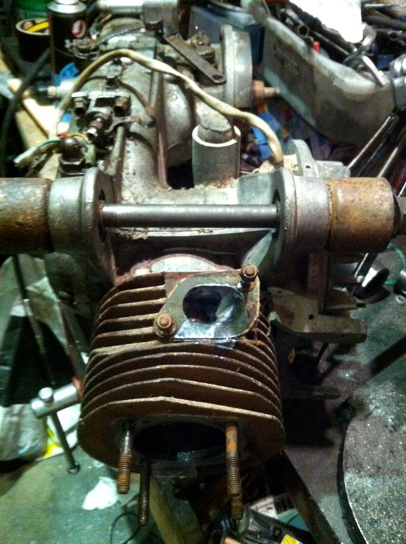

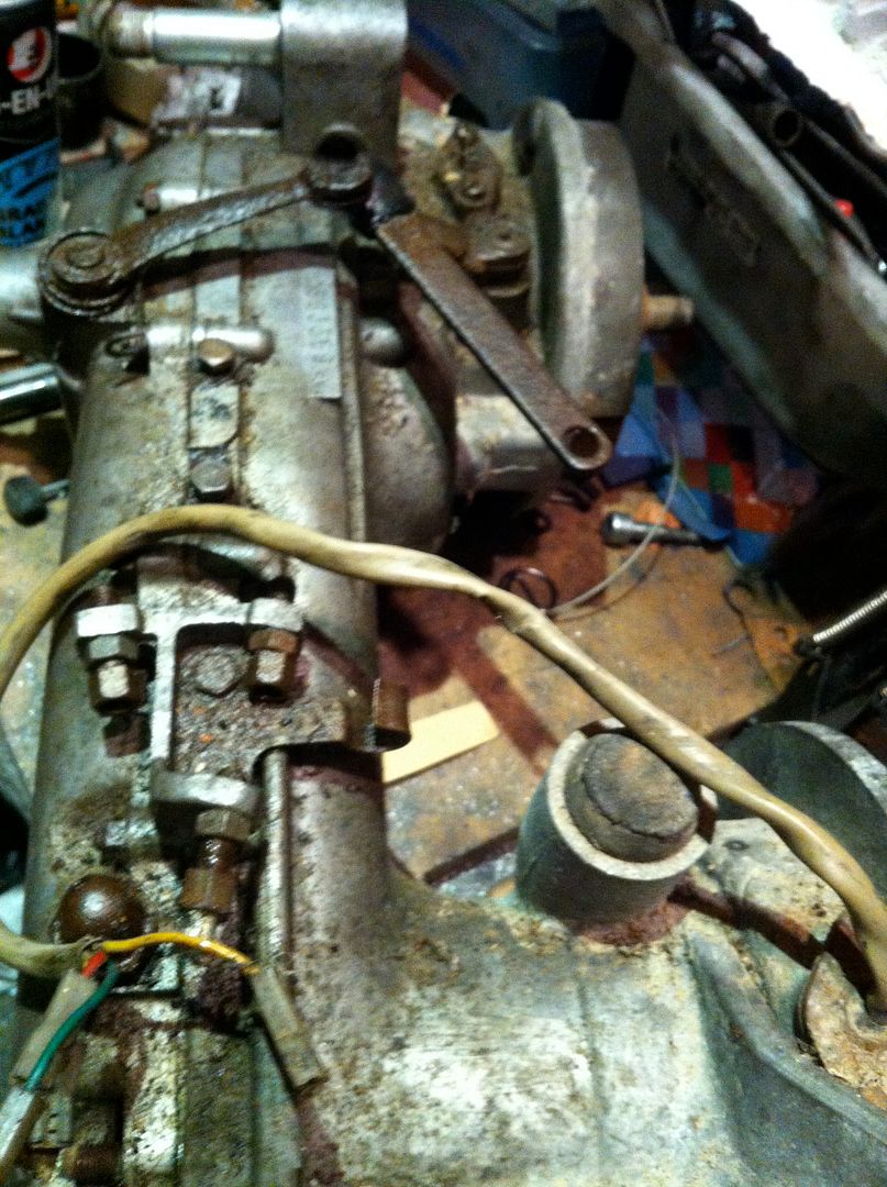

engine's home:
SX200 5.... looks like a jet200 says Spanner's
engine is stuck...

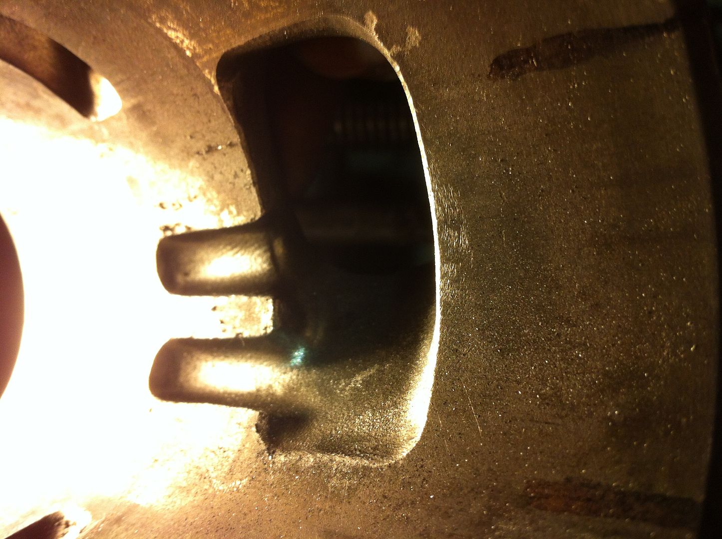

hum! yanker 24 bhp?? I don't believe so: maybe 18. I can't imagine this old stock barrel able to give such a big load of power. Anyway we shall see later. Maybe a dyno...
begining of the boost ports. Second one will unfortunately come out in the manifold thread... Not a big deal but boring indeed...

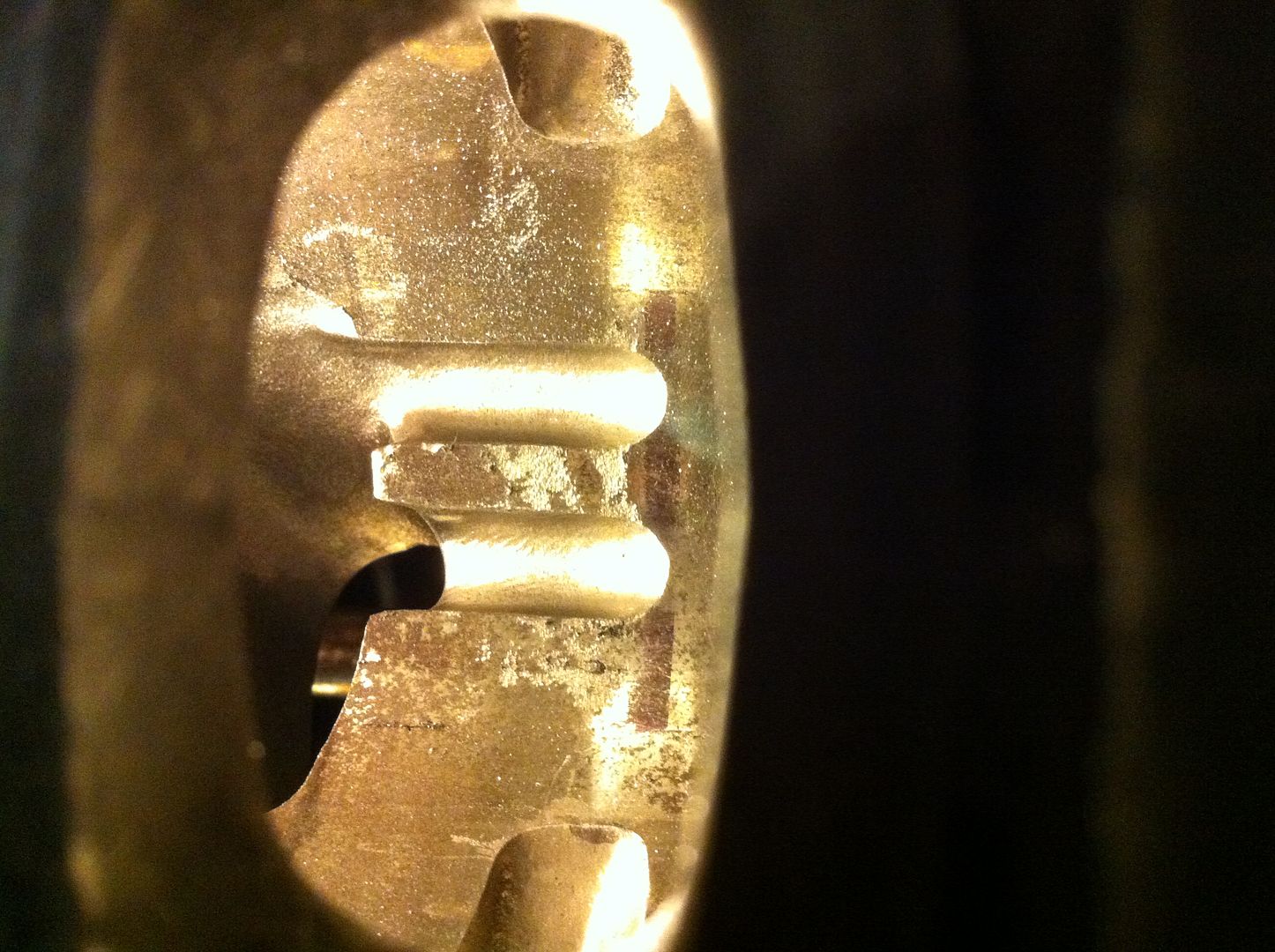

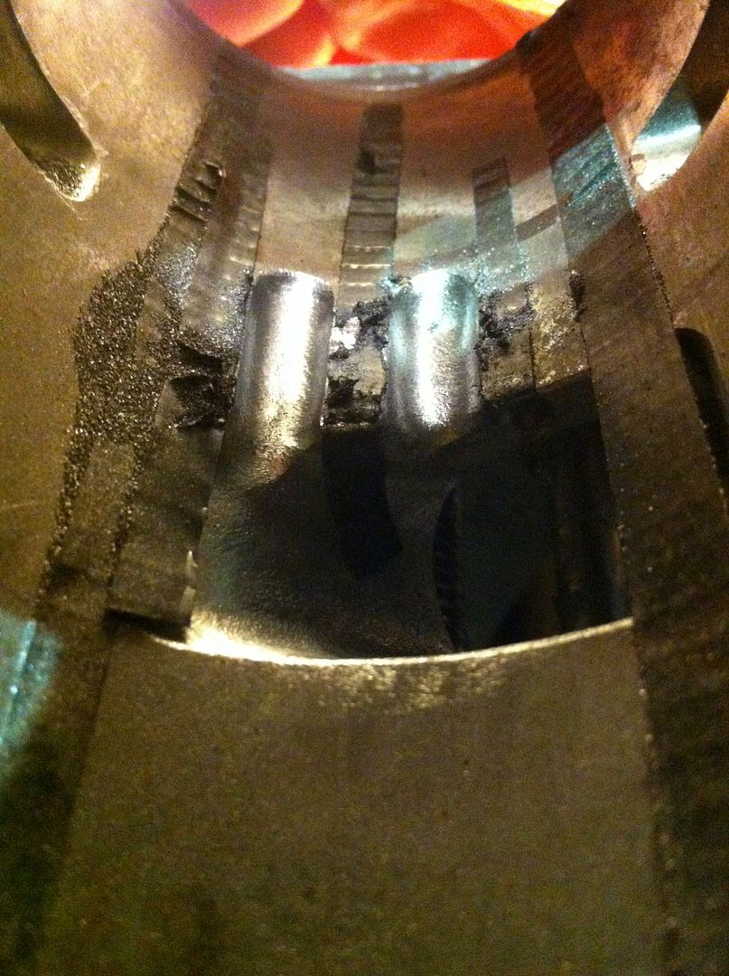

ok 2nd BP:
first in-out, in-out
10 min later:
baby faced:
Clean but just need to go a bit deeper cause reboring (from 66,5 to 67,5 mm) would reduce them about half a mm. Oddly I'm still away from the thread....

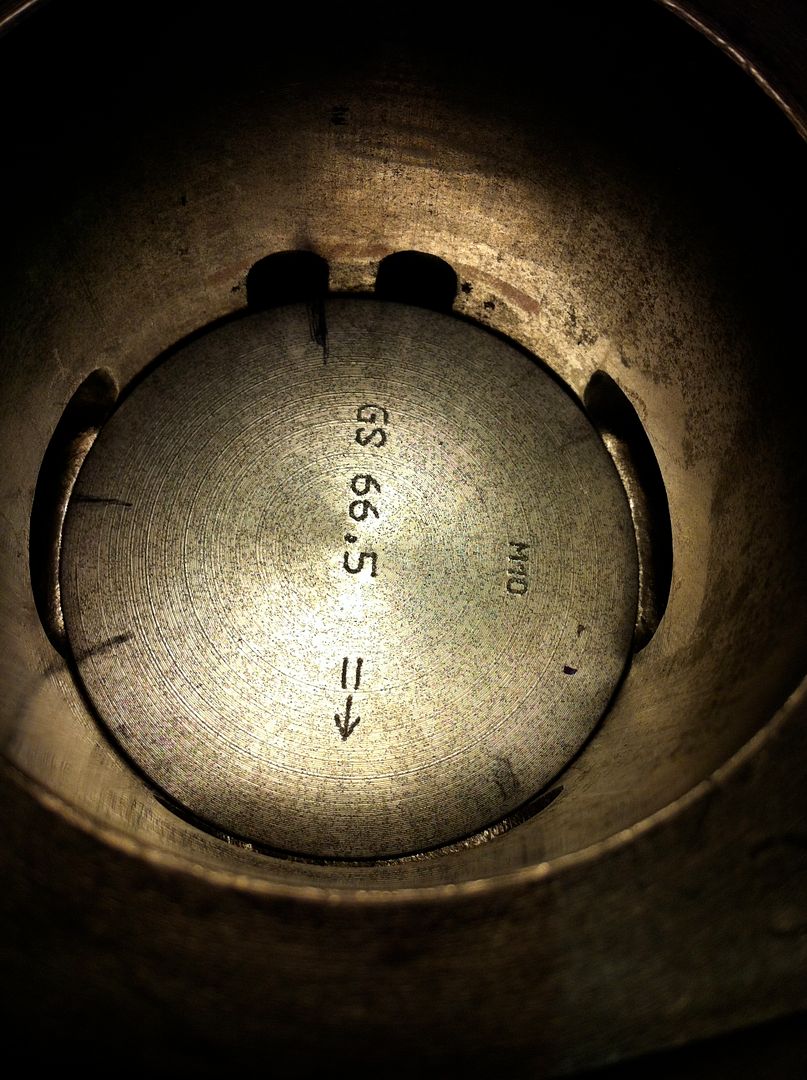

piston inside:
I keep the idea to get a big 3rd port by joining the both small ports. Could be a future update....
