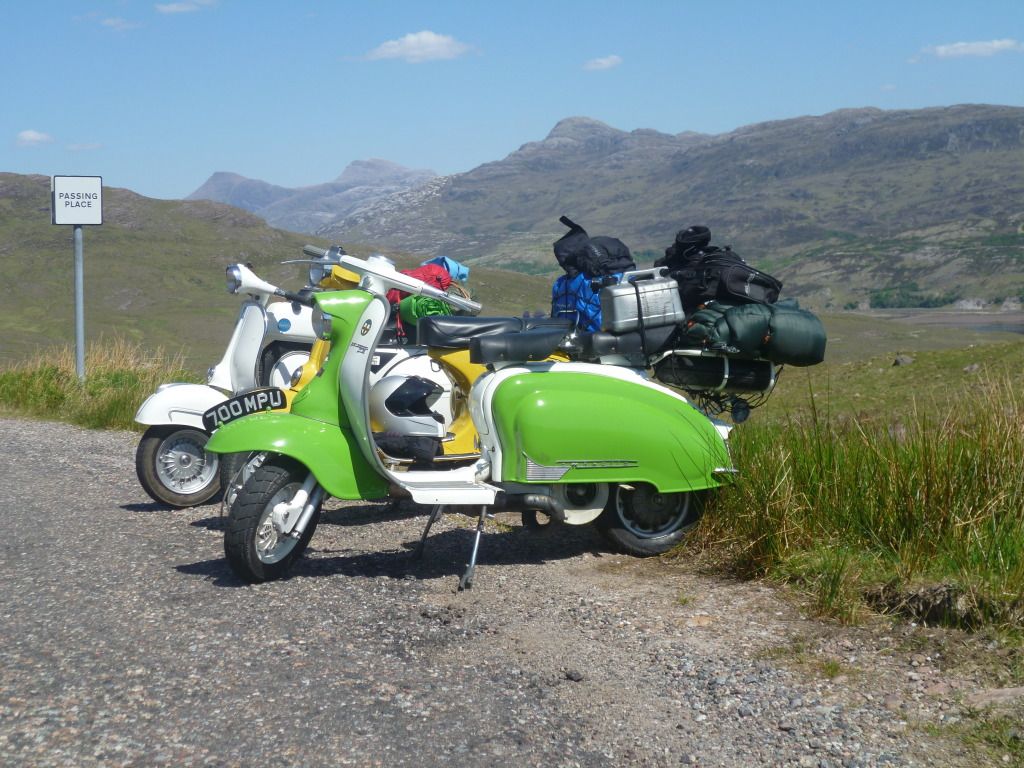

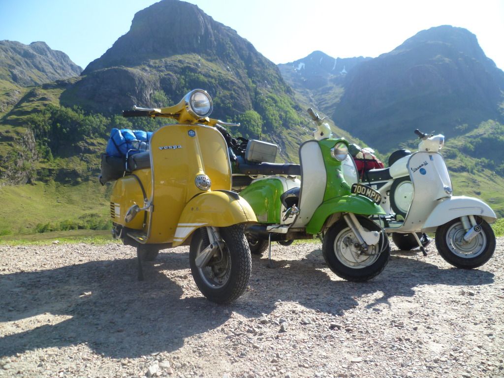

Thats the avanti ran in now this time last week id done 50miles. a couple of hundres local miles through the week with a 500 mile trip into the highlands..
have to say how much less vibration the avanti has, i was driving without gloves wot with the weather being so nice normally youd have white finger and buzzed hands..on a lesser note if it gets out its preffered rev range you find yourself knocking down a couple of cogs (li150 46 16) but all in all a fast tourer.
p.s sorry for the veshpers :ninja:
