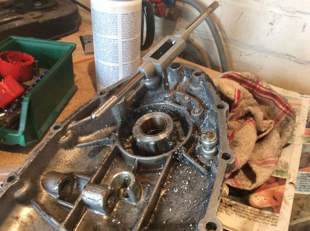

Whilst I'm waiting for the new mag housing and all the other new engine parts I thought I would fit the Li ramp to my side casing. I'm fed up of not being able to set the kick start properly on my other engine (GP end plates) so I thought I'd give this a go, my Li engine's kickstart is perfect as it has the ramp. Hopefully this will make for easier setting and starting :D
This is the first time I have ever cut a new thread so was very happy it went without any problems......

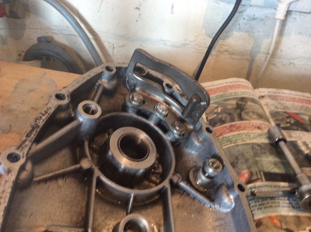

Fits perfect :D

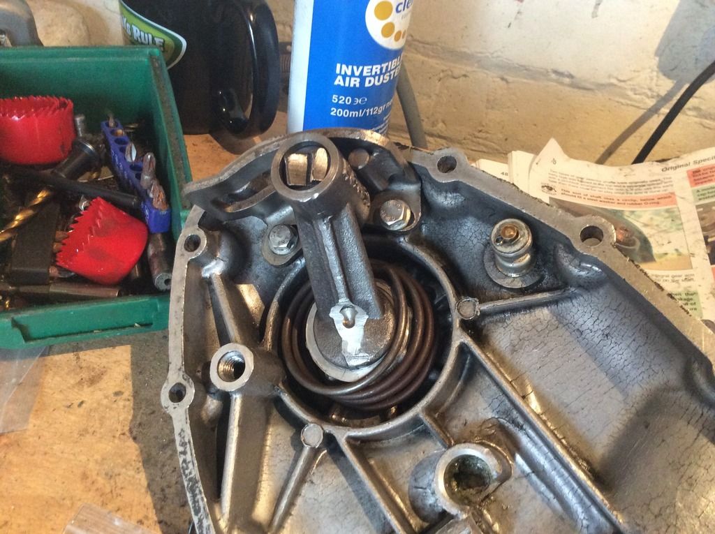

Fits and nearly wokrs as it should! I am going to have to take it off and made a tiny adjustment with the Dremel as the piston pin catches on the ramp on it's return and this stops the kickstart going back to home, nothing major just a little file here and there will sort it :D

The spring doesn't look quite right?
alanscottj
Posts: 960
wack 63 wrote:The spring doesn't look quite right?
Yeah, I've just had a Google and looked at some,it's not sitting my right is it? I'll have a fiddle and see if I can get it to sit better......any tips most appreciated ;)
Lambretta Series 2 Rat - RB260, SuperTourer, Cyclone 5 gearbox 😎👍
Muppet
Posts: 1279
is it upside down
C’est la vie
alanscottj
Posts: 960
Muppet wrote:is it upside down
Whoops :x :lol:
