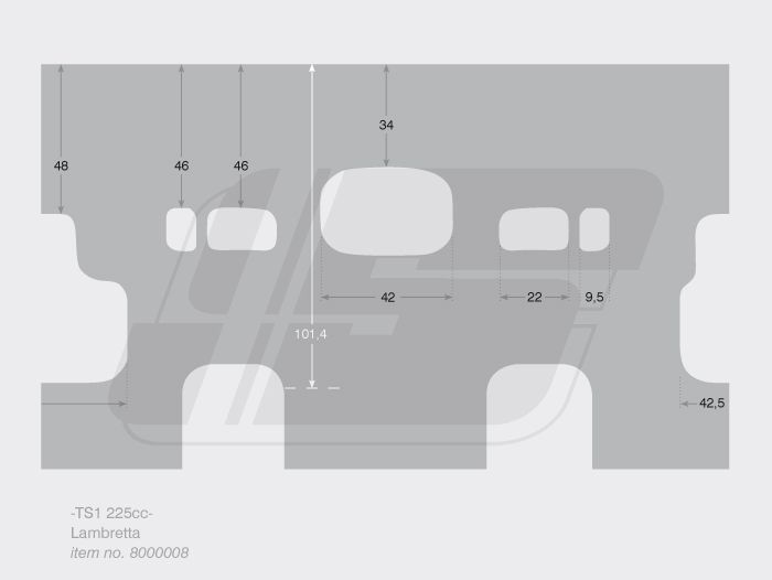

The ts1 is a very nice air cooled reed valved barrel.
Here is the port map
Dont be fooled by the areas.. you have to take into account the angle of entry of flow. So, in reality the areas are much smaller espiecally in the secondaries which run two basic flow angles, so your output flow area is much smaller than what you see on the port map. Also the ts1 secondary ports run no kicker so secondary flow tends to disrupt boost flow and therefore loses area at the same time.
This is the T5 malossi barrel.
This barrel is not restricted by the narrow barrel studs (on one side) as the lambretta barrel is. It has a symmetrical stud layout. So much more area... and therefore so much more potential.
I think Dan has a very valid point in that due to the (comparably) un-popular nature of the vespa t5 that less has been developed for it pipe wise. In fact pipes for large frames are pretty poor and thats why Oz realised that a one off pipe from PM was required to draw through the small ts1 ports to make the conversion work well. Which it does... But how well would a pipe draw given much more port area to begin with...

an example... this is a 125cc Quattrini M1-LR... this is a road kit you can buy off the shelf for the smallframe casing.
Its 125 cc made for the smallframe vespa.. again its restricted by the barrel studs ( as my racer is) but just look at the area it has..
And here is the Rs125 Honda
This quattrini barrel (the image above the one above) makes around 18hp before tuning and I believe its what Sticky runs, albeit with a 54 stroke. His bike flies. I have seen it, and I guess at around 24hp judging by his laptimes and the fact he can ride the thing very well.
