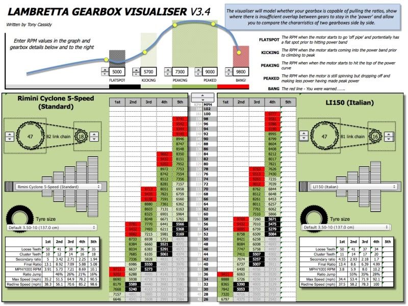

drunkmunkey6969 wrote:How/when can people get V3.4.0. ?? ;o)
Hopefully within a week - Just a little bit of tweaking, spelling and then need to check it works ok on a couple of different computers and then I'll upload it to the link on my signature.
Here's what it currently looks like - I'm resisting the temptation to make it even more geeky in the interests of simplicity, but have incorporated some nice UI suggestions from Darrell.
Back to the 5-speed box, the power profile here is from a recently discussed motor and puts the Cyclone against an Italian Li150 box. They've a similar final drive, but even the Li150 drops out of it's peak power band between third and 4th, whereas the Cyclone sits in the power through 3rd, 4th and into 5th.
Tony
