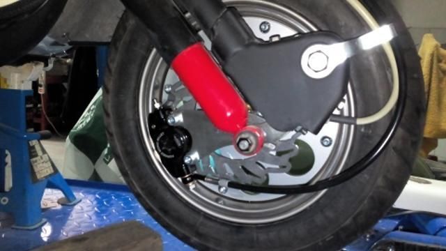

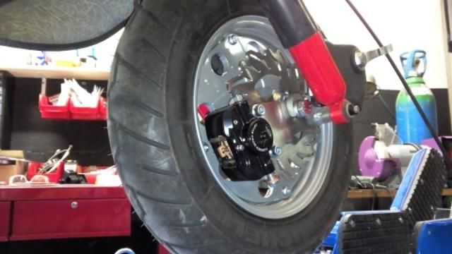

little update with a Pm disc brake conversion. The front drum was a nightmare and barely braked. Swapped it for a PM tuning volante without anti dive. I really dislike those late 70s systems that freeze handling and leaning when braking. Hazardous and unpleasant brake feeling for sure. better use harder shocks than anti dive....
Anyway the volante with its "back from the future" look fits discretely. I don't really care about the circular saw design of the disc.

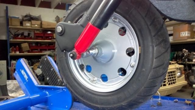

Some good news from Paris. got my papers (V5) last week. What a struggle with a spanish former owner.... more than 4 mouths to get the file completed.
I'm very close to completion by now. I'm having problems with the front tool box fitting. Leg shield was in such a bad shape that box couldn't fit properly. There was almost a 1cm gap between the 2. We had to weld extra matter to get the perfect shape. Box needs a good spray before being bolted on.
brak disc conversion:

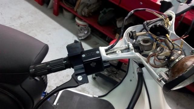

Electricity nightmare. None of the wire matchs the color code shown in the the sticky's book diagram... I'm tearing my hair off!
But things are almost completed this evening: beam, signals and horn are working fine with the battery. The DC conversion is a hit. It works fine and gives a regulated straight curent whether the engine runs or not.
