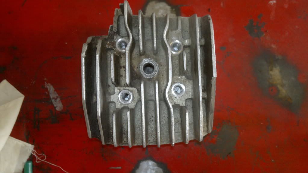

MZ cylinder head for Lambretta 200cc
any one care to ask here ??

saw a finned cylinder head on a race lambretta at lydden
was a huge rectangular shape that looked offset with the combustion area and the head sort of extended down lower aswell with a scoop below to angle airflow up and over the head
havent explained it well sorry

Maybe this one...
sydduckett wrote:Chalky had a f**k off great head on his racing scoot at Lydenn but wouldnt reaval what it was off, he did give me a clue but i was pretty wan*ered when the conversation took place so i cant remeber that much. :o He also had a large scoop which was held in place by 2 springs over the top of the barrel, very simple but effective. You would have to drop the shock to get at the plug but thats no biggy.

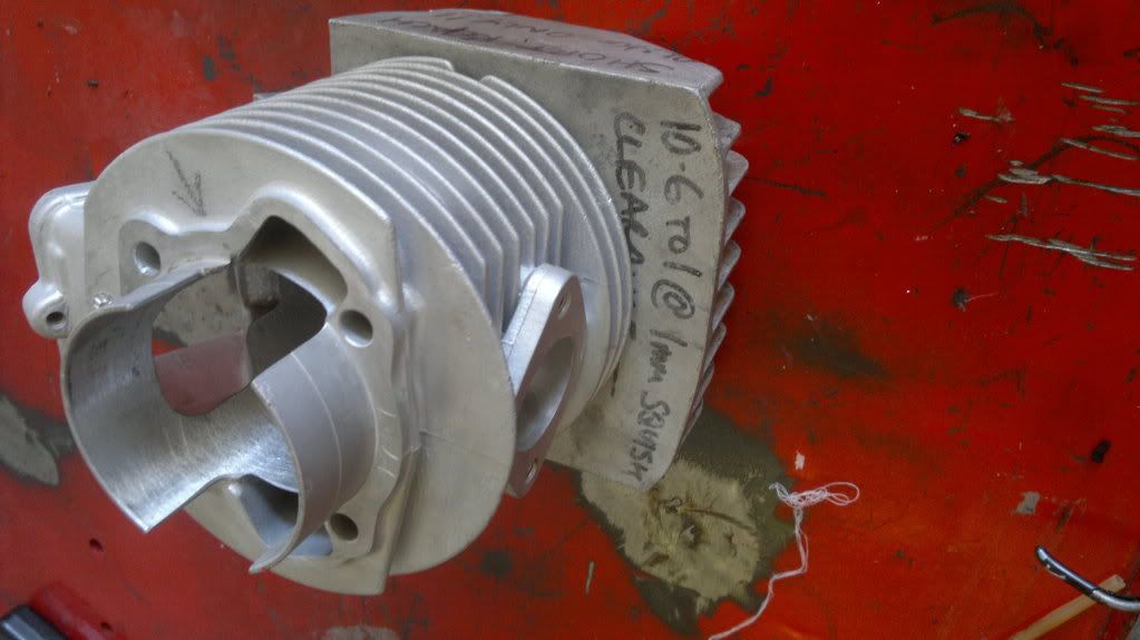

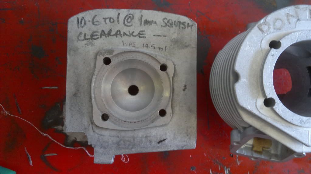

mickdale wrote:saw a finned cylinder head on a race lambretta at lydden
Like this?
sydduckett
Posts: 1900
Like this?
Yeah that the sort i saw, i dont think all the racers defo use the MZ, they all seem to have that rectangular oversized head but off diffrent makes of bikes. On your pics you can see the large area at the back where the barrel meets the head. It wouldnt take a lot of fettling to cut down a standard cowelling and butt it up against the back of the head. This way your always cooling the barrel whenever the engines running. May be a bit belt and braces considering what prev posters have said but would surley improve overall cooling even more..?
