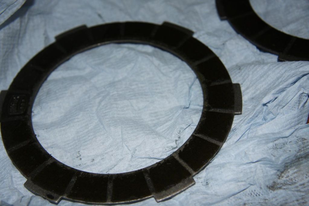

I soon had my new engine in my bike and it's fair to say it takes a strong kick to start. But it's not an issue. I was soon out on the road to put some miles on it and get it run in. Having put a few miles on it I went out for a ride with my son who has a well sorted RB20 (Thanks to Geoff Stevens). All things considered the Avanti faired pretty well. It's no screamer the power delivery is nothing like the RB but lower revs and greater torque means you just punch through the gears. After not very long and I really mean not very long this sort of behaviour led to this :-
One bad case of f**ed clutch syndrome.
At this point I was very disappointed, I needed to spend yet more money on this engine which had already cost enough. So out the engine came and in went my other engine (Rapido 250) while I saved some money. Now the good thing is the engine had to be making pretty good power to muller the clutch so fast and in such an awesome fashion. The bad news was I had to spend some serious cash on a serious clutch, heavier springs were another option but I don't like a heavy leaver for me it isn't fun .

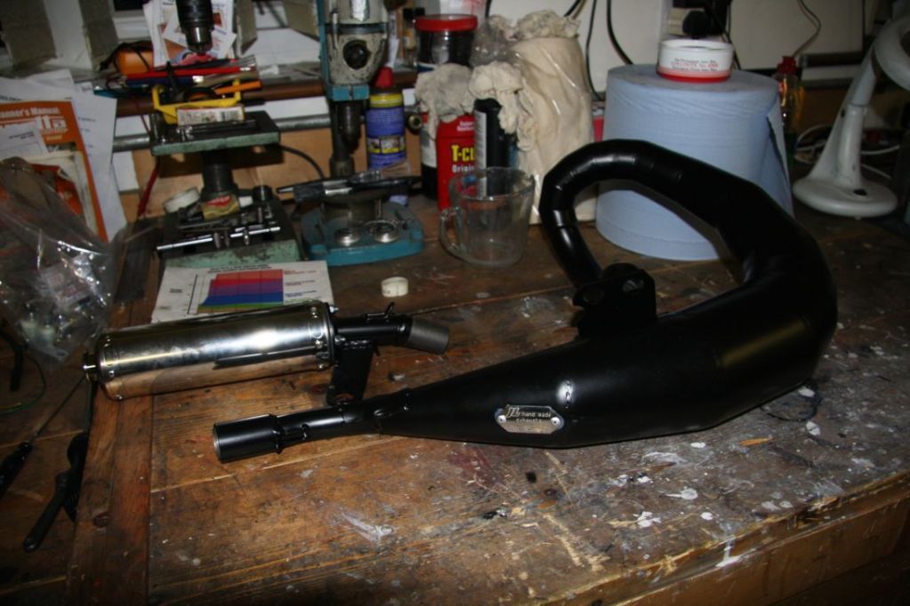

We also had a spare Varitronic ignition kit lying around the garage, (something to do with my son) I dunno it was new and doing not much. I put the Avanti engine back in the bike with all of the above. I also have a franspeed tour pipe which I'm interested to do some comparisons with on the road, but for now let's see how the ADS3 goes.
