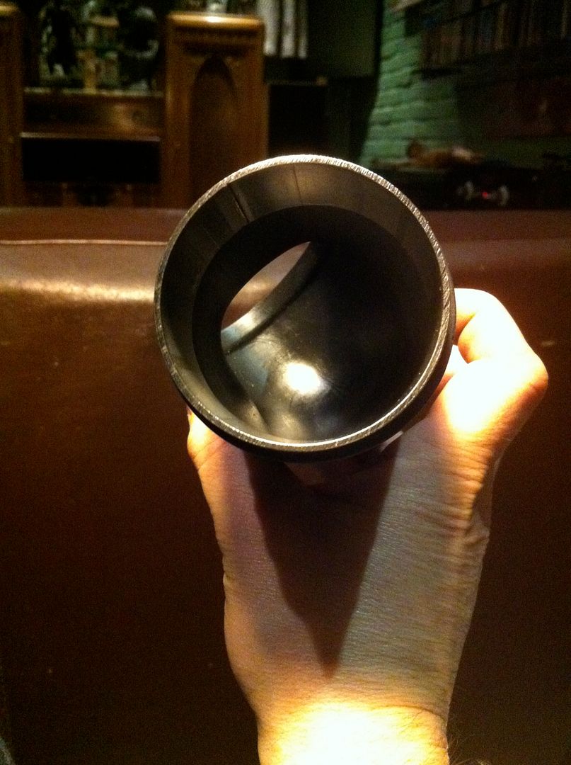

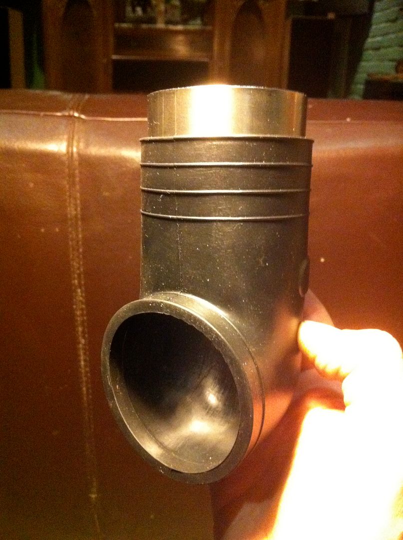

Breathing sweet becomes a chewing gum as engine warms up and risks of collapse are great if rubbing against panel...
find a 60 mm ext tube to joint ramair and stiffen the whole thing. I'll probably cut it at the first bellow mark to get it even stiffer.

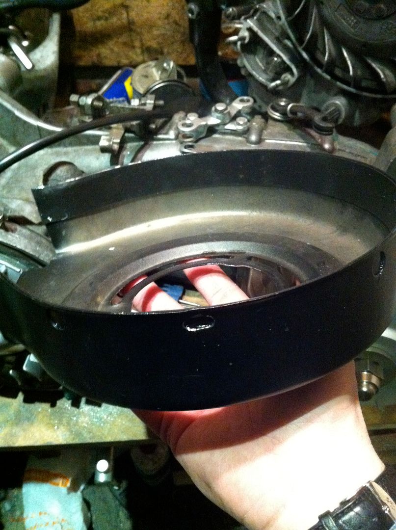

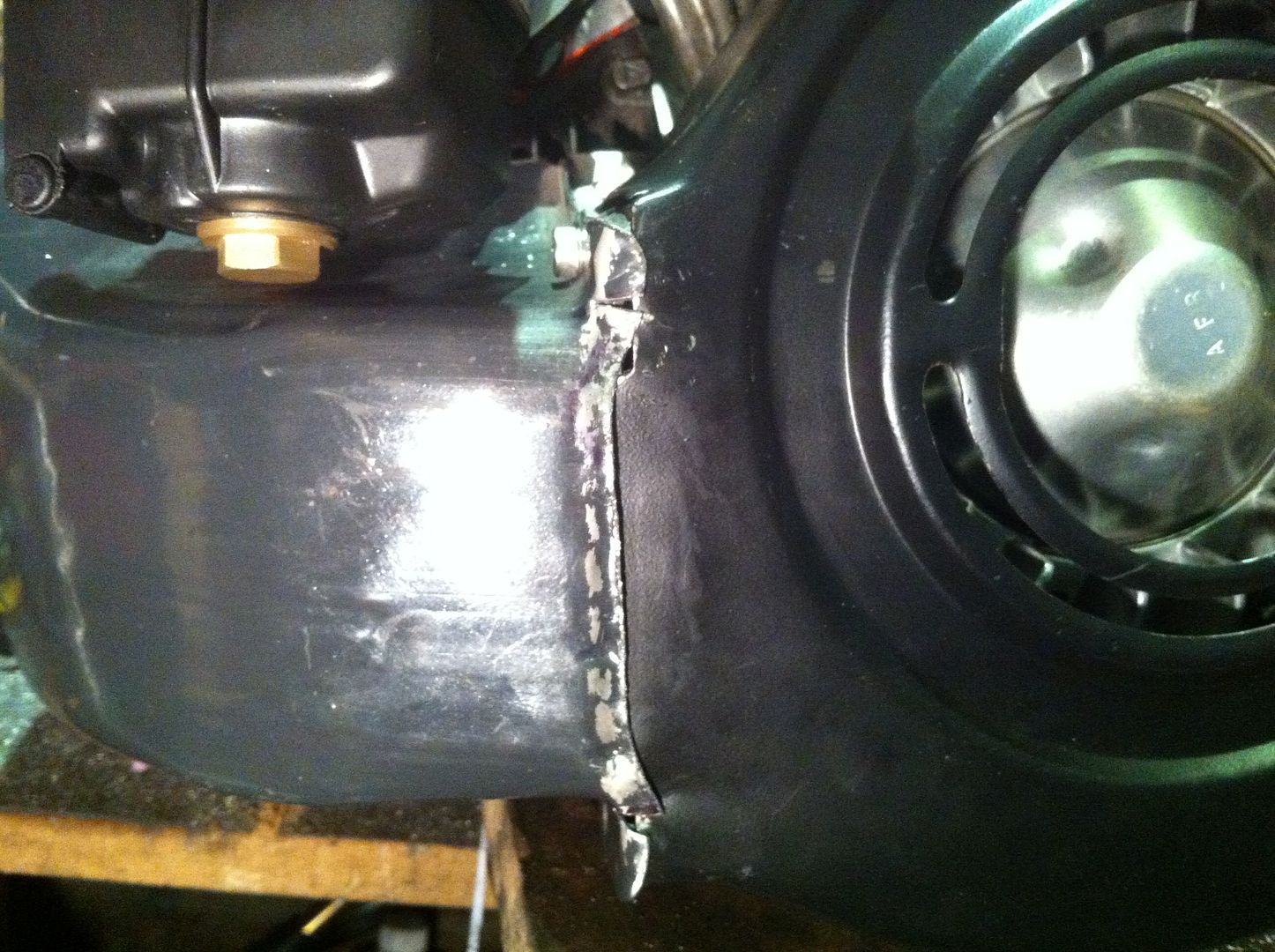

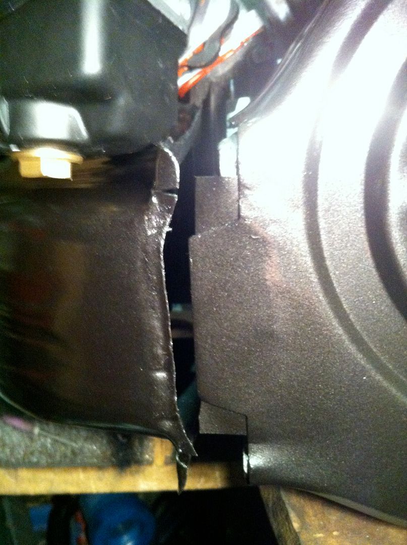

I received cylinder and FW cowl. obviously cheap repros..... Cooling needs a good sealing treatment... between mag flange and cowl is a 1mm space, between the 2 cowl is a 0,5cm gap... All this p155 me off..
I'll cure mag cowl space with a 1mm thick heat joint stuck in the inner side of the cowl. I'll try to cut the cylinder cowl and bend it against the mag cowl to get the whole thing more tightly fitted.

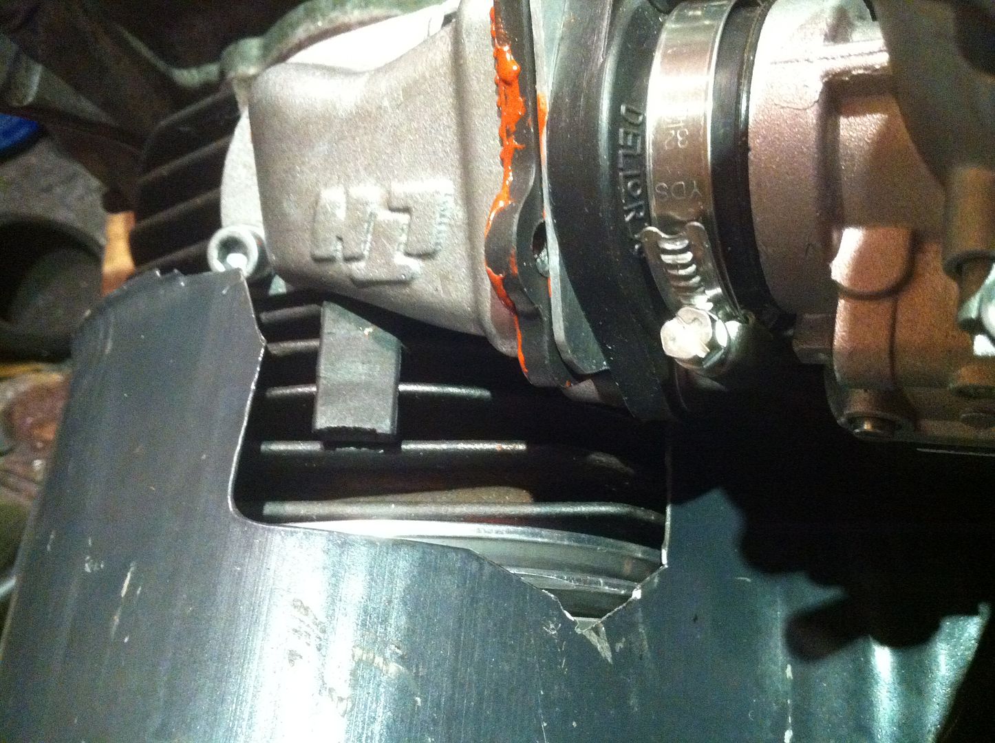

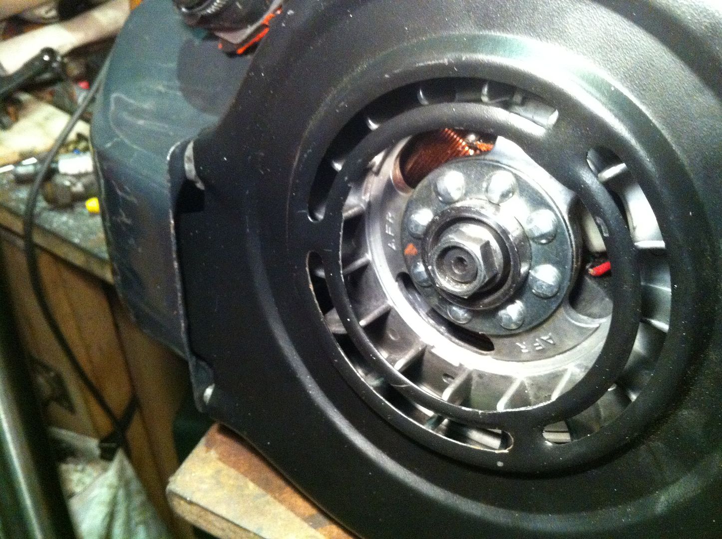

I put 2 T5 cylinder rubbers to avoid rattling noise between cowl and cylinder:
Size matters!
i notice that you havnt fitted the dust cover onto the flywheel ? ...any reason why not as i would have thought that it also would aid the cooling air to flow in better
loving this topic/thread btw :)

it was just a trial.... trying to get the best of the cowls....
I hammered the cowl hedge to overlap the best I could those 2 holes remaining when everything is fitted. This is an "in progress" step....

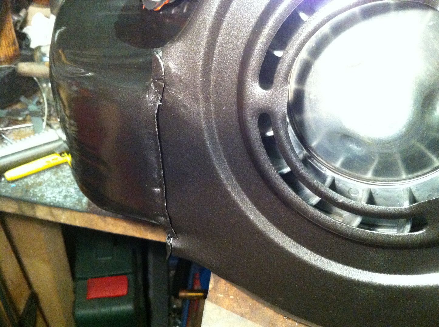

RI tried to solve the rattling/ air leaking issue:
I put some plumbing rubber stuck inner side with epoxy.
