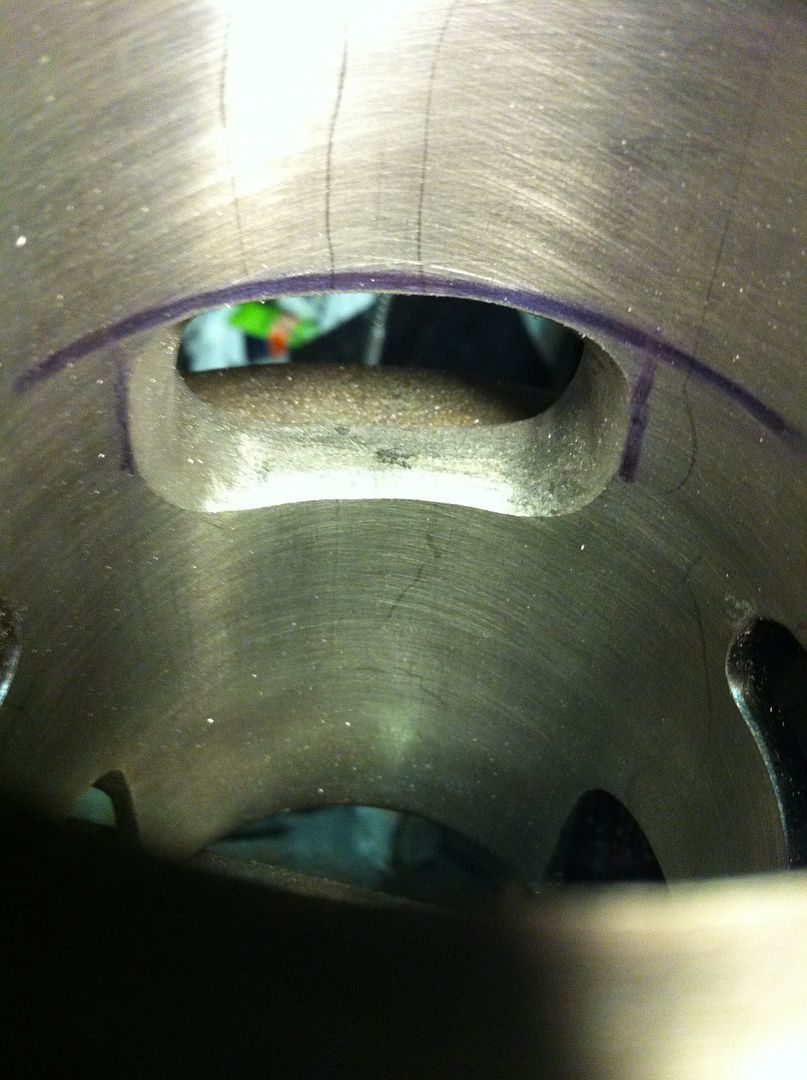

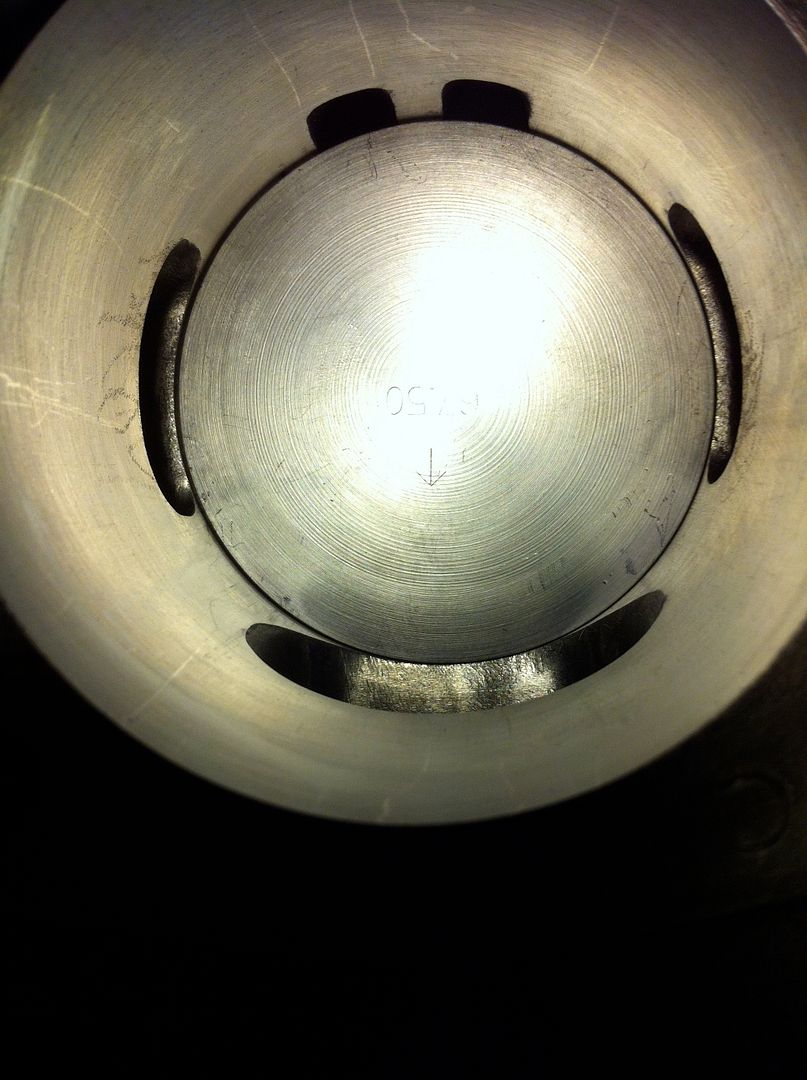

exhaust porting in progress:
Size matters!
fastfrog
Posts: 412
Location: Paris, Taxes
progressing:
Size matters!
fastfrog
Posts: 412

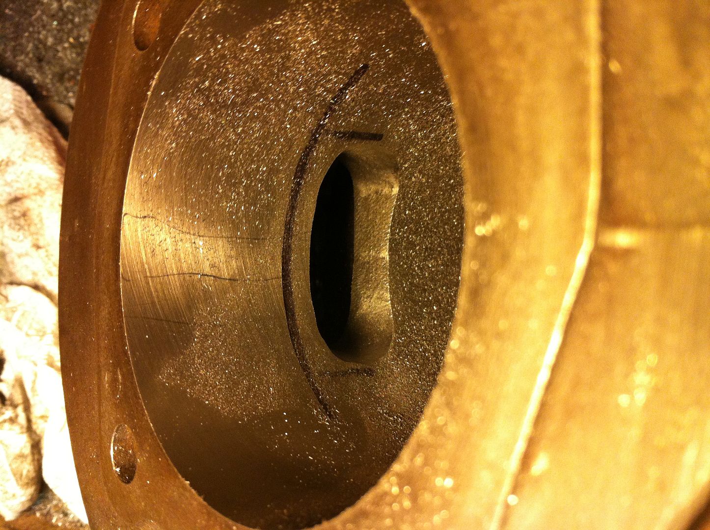

close to completion. Still waiting for a decent flange to match exhaust port to it....
Size matters!
fastfrog
Posts: 412

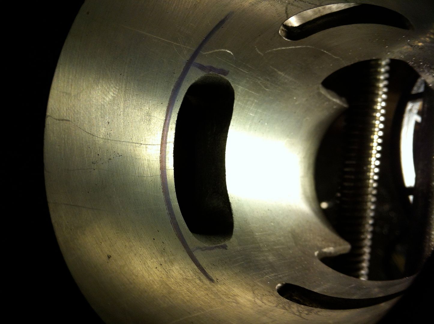

a bit polished: it begins to look like it should be:
Size matters!
fastfrog
Posts: 412

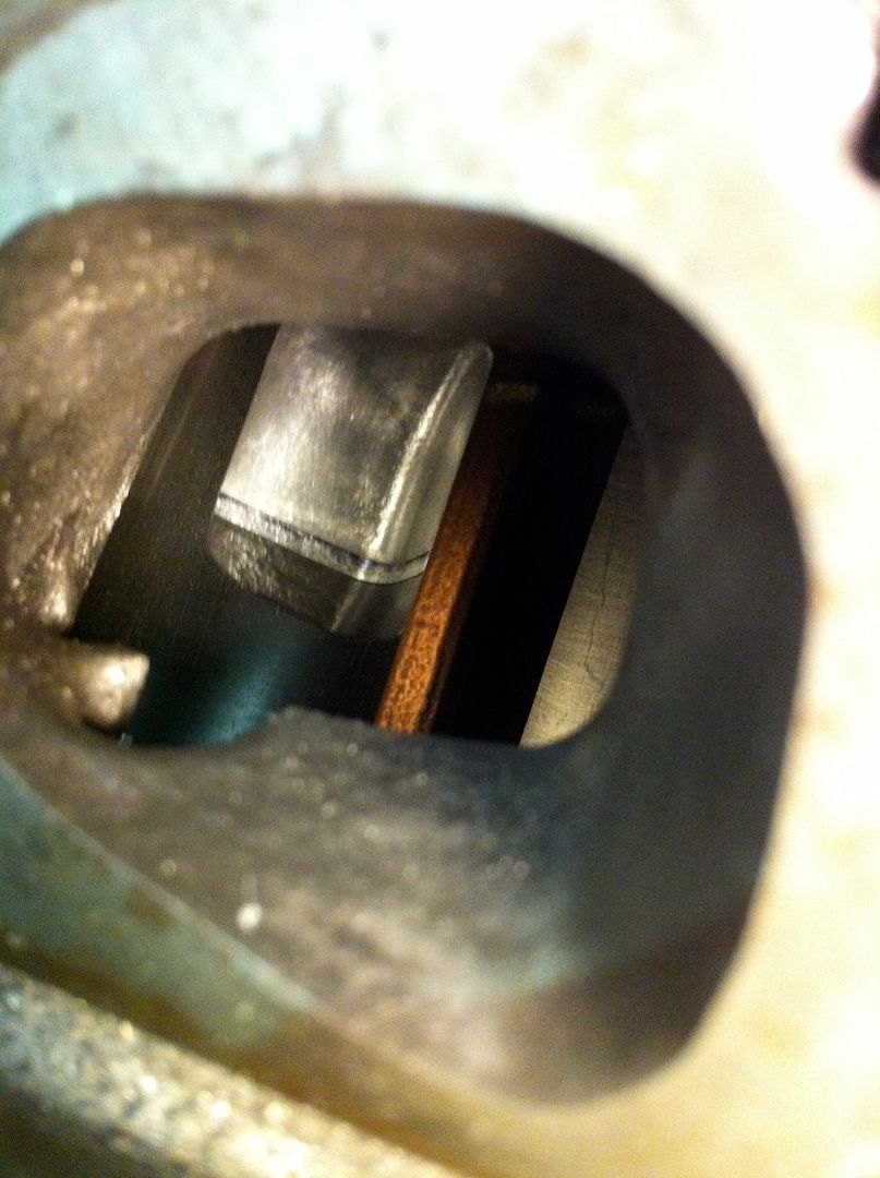

44,2 mm wide. I guess it's enough for this first attempt.
transfer port through the inlet:
Size matters!

many thanks. I'm gonna check my squish clearance this WE. Got plenty of head gaskets but need to oversize them to 67,5mm( from 66,5) to proceed to the checking.

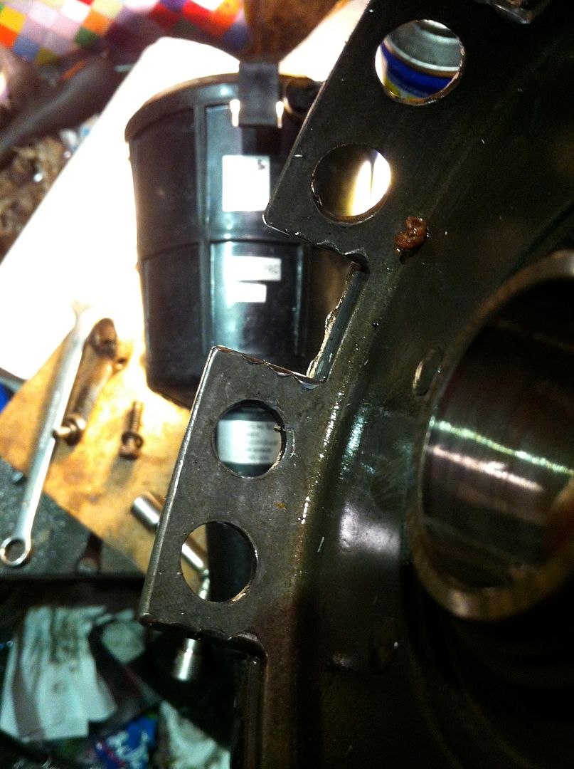

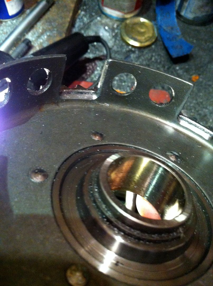

meanwhile i had to look after my clutch: an almost fossilized specimen.... Bearing model with a quite devastated basket:
before
after
Size matters!
fastfrog
Posts: 412

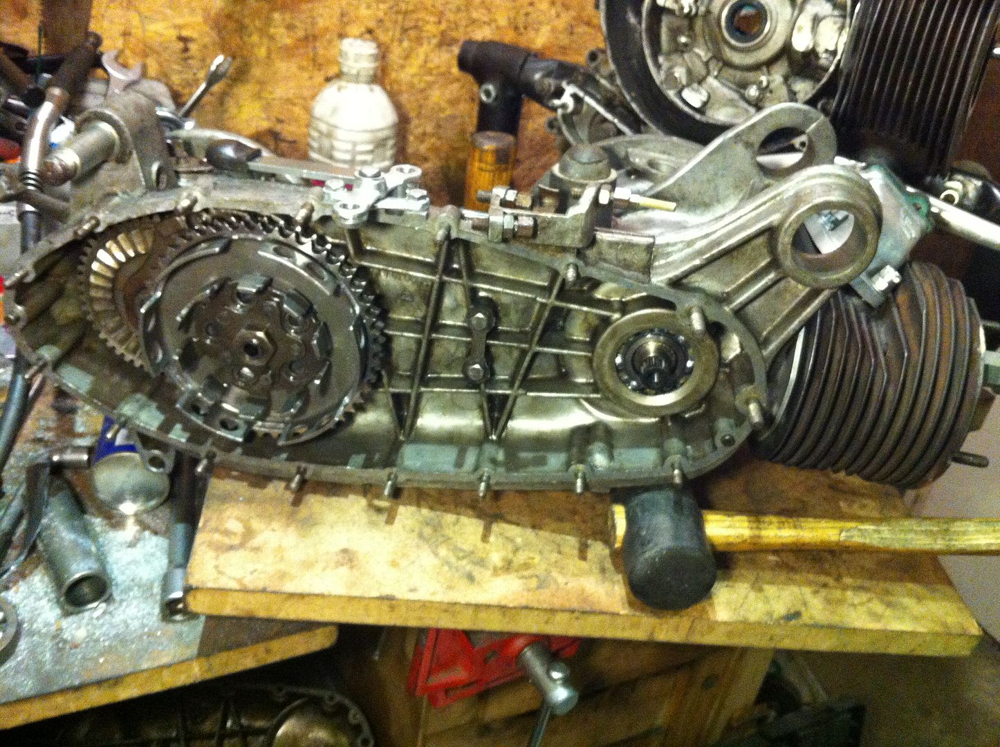

rebuilding on its way:
gearbox reassembled, perfect play (0,04mm), everything seems to just fit perfectly. My previous grinding op of the layshaft has produced its results: Now the big shim rests on the 1st gear and leaves free the layshaft.
