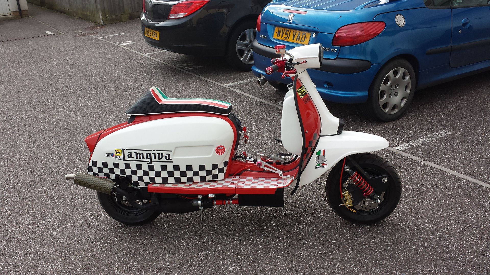

carpark at dusk
headlight on, not sure about using it, but it looks cool, I dont really ever ride anywhere at night.

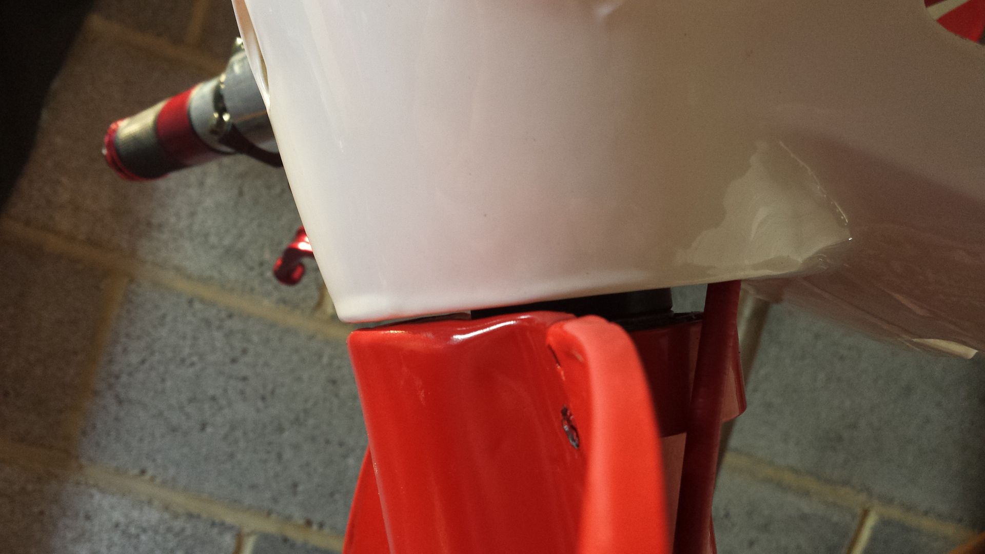

central heating

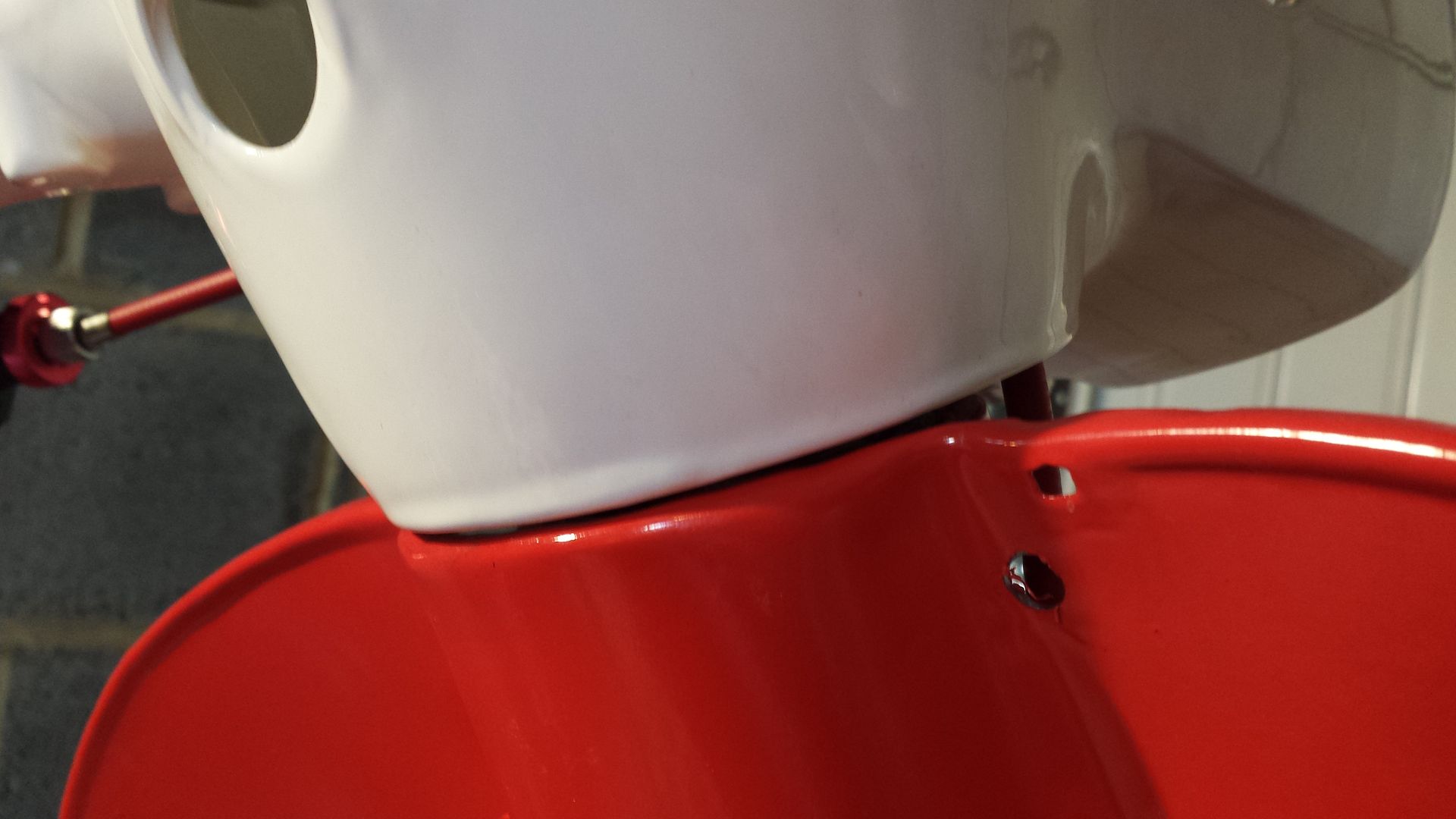

headset fit which Im quite proud of, seeing as the frames not lambretta and all the parts were ebay specials and repairs etc

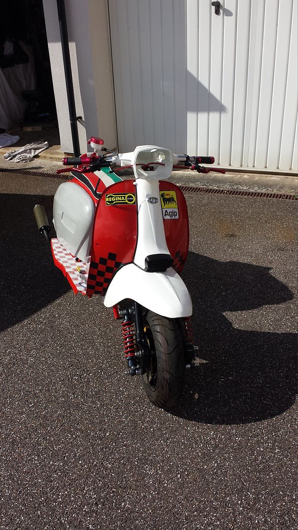

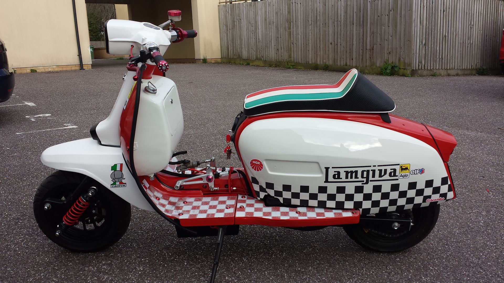

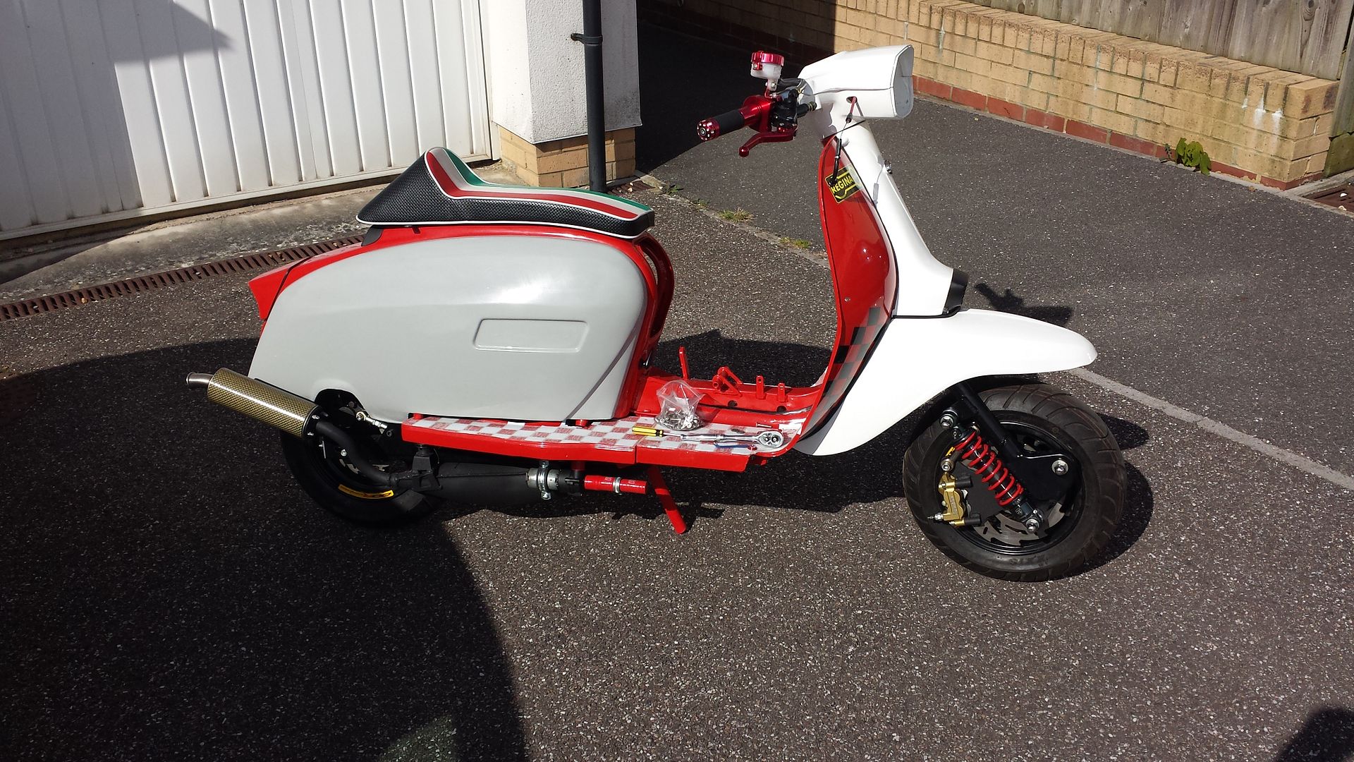

getting there...not, still heaps to do, but seeing it like this spurs me on, sidepanels are currently with the painter. Rear runners not bolted on in these pics, now mounted properly.

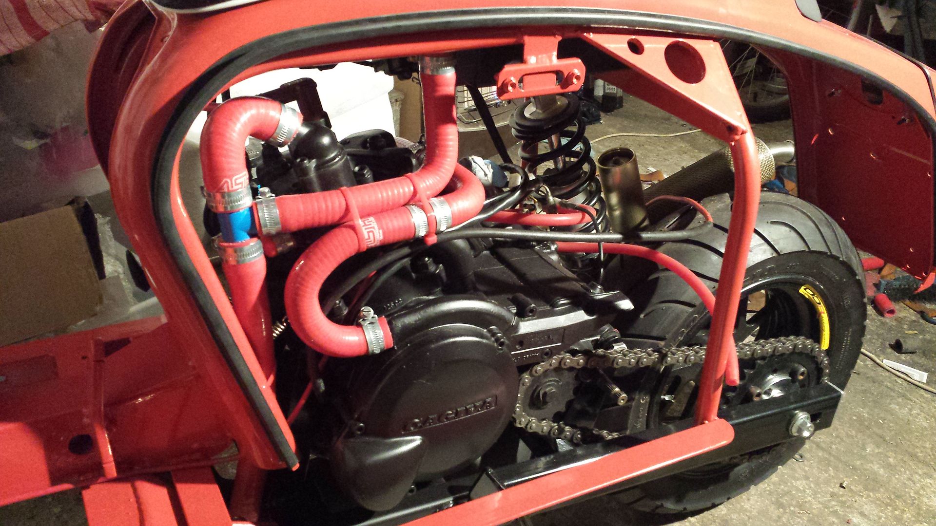

brakes are all bled and working, front is feeling great (anti dive doesnt lock it solid, it moves a bit and I like it the way its worked out), rear I think I got calculation wrong somewhere, master cylinder too big, so it works but appears to lack feel, however thats only from testing in the garage, also its new pads and disc so maybe they need time to bed a bit, if it prooves to be horrid on the road then I have an identical master but with smaller piston, that will give more stroke and should equate to bit more feel at the pedal.
plumbing is all done, electric waterpump works a treat, starting to sound like a space ship when you turn the key, powervalve cycles and water pump whirring away
hopefully have last of wiring finished tonight, relays for kill switch, water pump, fan, headlight
plan is that I will have tank and sidepanels back from my mate by end of week, sidepanels arent a worry, tank I need, but I have a test tank I can just test fire the engine with, need to start getting busy with plug chops and try to get the jetting somewhere near right, except I havent a clue LOL
got the choke setup using the original GP choke lever, that was a nice feeling as its just one more bit that helps it look original, got to check for clearance and fit but think I will put a fan bypass switch in the fuel tap hole, so I can bring the fan in manually in case of any problems

first off had fuel starvation issues, was using a minimoto tank bungeed to the seat just as a test tank, wierd things happened, the petrol appeared to be stripping off the inside of the tank and depositing a clear jelly like substance in the fuel lines and carb :(
Ive messed about and played tih the jetting, but havent a clue what Im doing, its currently running a PHBH28 carb, but also putting together a PWK28 setup as I was told by a tuner that the PWK is easier to jet for something like mine thats dependant on an airbox and now running a ramair filter
legshield trim needs finishing, just waiting for the sharks teeth, and last night I dug out the old tacho from the bike, I knocked up a basic bracket and its going to be mounted on the RHS of the legshield, nice big face and illuminates red :)
front brake setup works very well, rear brake is dogpoo, think theres a problem with it, as the master from the original was 12mm, and Im now running a 1/2" master, but it goes rock hard with minimal travel and simply does nothing, can stand on it and bike doesnt slow down, strip and check caliper, any issues will either source new one, or change it for another type, maybe match the front but then have to make all new mounts
