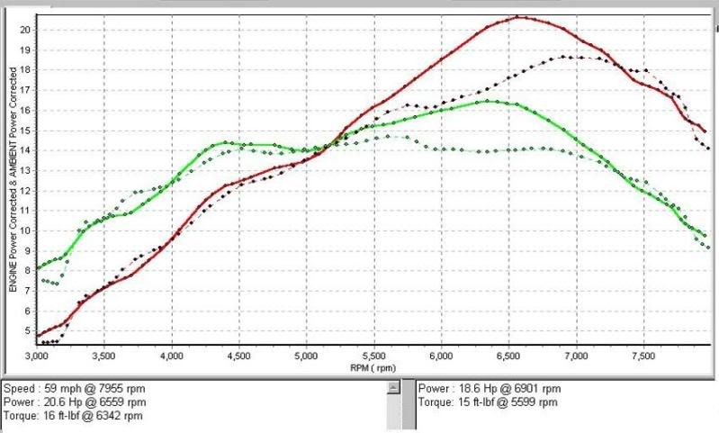

lozmondo wrote:Ian has this modified clubman been run back to back with say an AF or Tino one? ..if so I assume it must compare well to be used in this comparison.
looks interesting.
I lose track, suffice it to say there is a large pile of clubman type exhausts with various things done to them.
It's been tested against an AF clubman. The clubman in the graph is a heavily modd'ed tino clubman (the swan neck was an inch out!).
looks interesting.
"Lozza
Here you have it, this compares our modified Clubman against a standard Tino Sito Anncilotti clubman
Red and green MB Clubman dotted std Tino Sito Anncilotti clubman
Weve improved the lower down revs and torque and lost no top end.
Broady"
so is the MB clubman just a devtour with bits welded on to disguise it as a std looking type clubman...? :lol:
or is it unique and different..
looking forward to seeing some pics... :D

Impressive, I'll have one ...not sure how much longer my Tino clubman will last..will they be available by next Thursday before I go to Cobblesoul ? :D

Ian, or Mark, could you do a dyno reading of a AF reverse cone clubby V's a MB clubby please?

I find this quite interesting, as there is a whole world of science involed with an expansion and yet not too much in a clubman(well not that anyone has explaned to me :? ) yet simular results are yeilded..
