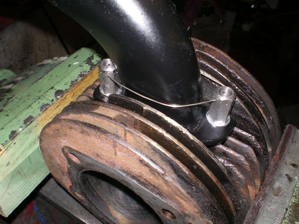

shocky wrote:Image
Good idea and the one I use but I fold the long tab over the edge of the flange.

soulsurfer wrote:
shocky wrote:Image
To stop the tab washer itself moving?
Yerp, Belt and braces, if the washer can't move, neither can the nut ;-)

Taffs (or rather the guys who took over the shop) sell wire lockable allen bolts which are a great idea as there's no stud to come loose.
Special X wrote:Taffs (or rather the guys who took over the shop) sell wire lockable allen bolts which are a great idea as there's no stud to come loose.
I had those and they seemed to loosen and allow the flange to blow, but it's tightening hi tensile bolts into ally that I wasn't too keen on, especially if removing the manifold all the time to stop it leaking :?
don't say that I've just fitted a pair of Taffy bolts.......took me ages to lockwire them too....thought that this would be the answer and I'd never have to lay down under the engine with an 11mm spanner ever again?

camel
Posts: 495
try washers called"nordlock"...i use them...basically they are two ratchet style washers that sit back to back,a good engineering suppliers should stock them if you dont go the lockwire or tabwasher route
