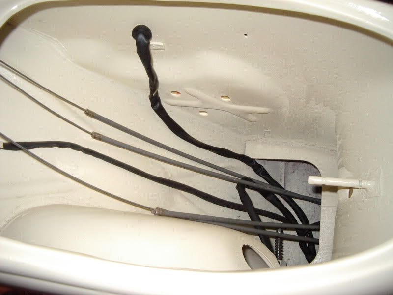

The latest problem is getting the new loomin, although I can get an outer cable through the frame without any problems, every time I try to pull the loom through it sticks...I gave up yesterday after about 4 hours of messing about.
I even stripped off the plastic coating on the loom and recovered it with shrink wrap to make everything thinner....keeps getting trapped under the strengthening support around about where the brake pedals fitted.
A mates bringing an endoscope camera around later so we should be able to see where the loom keeps getting trapped.........

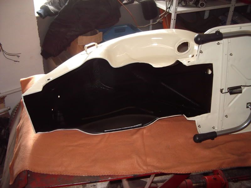

Decided to underseal the body;
Fitted the Cables and loom, the problem fitting the loom was caused by lack of knowledge, theres actually a small square hole for the loom to go through at the top edge of the internal strengthening plate ;)

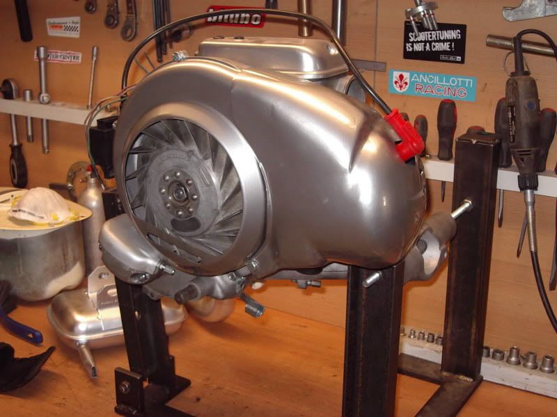

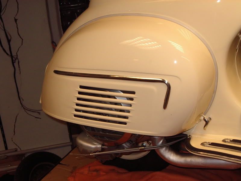

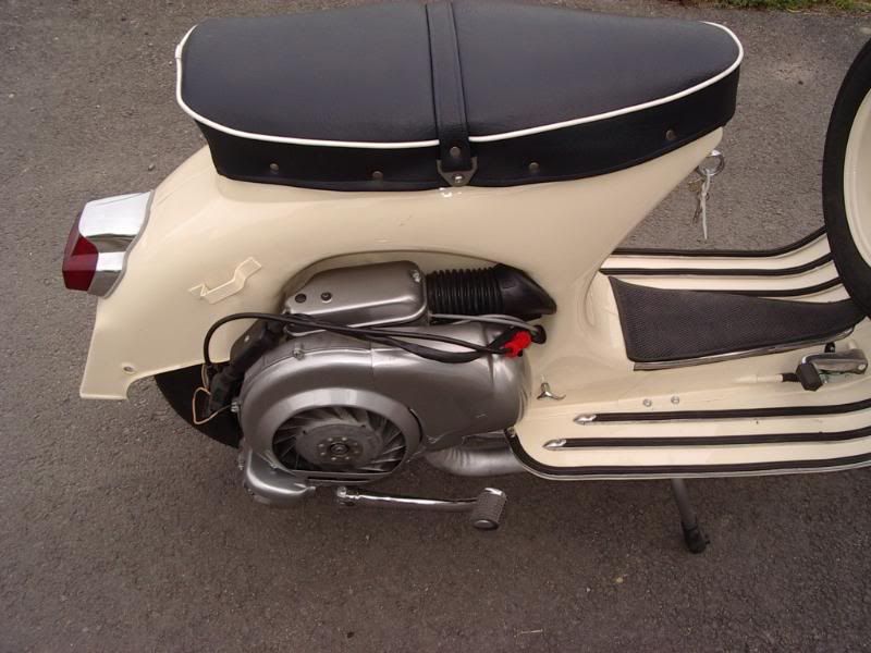

Finished the Motor, I decided to use the PX80 Motor with a DR kit. The cowls are off the GL as is the kickstart shaft and Kickstart.

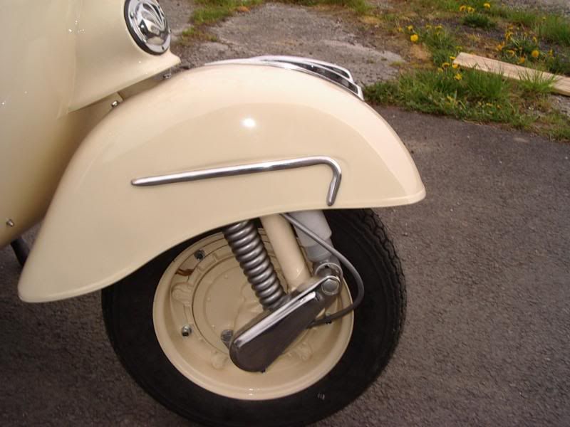

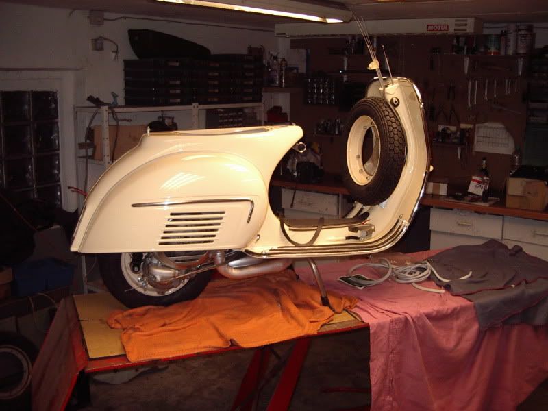

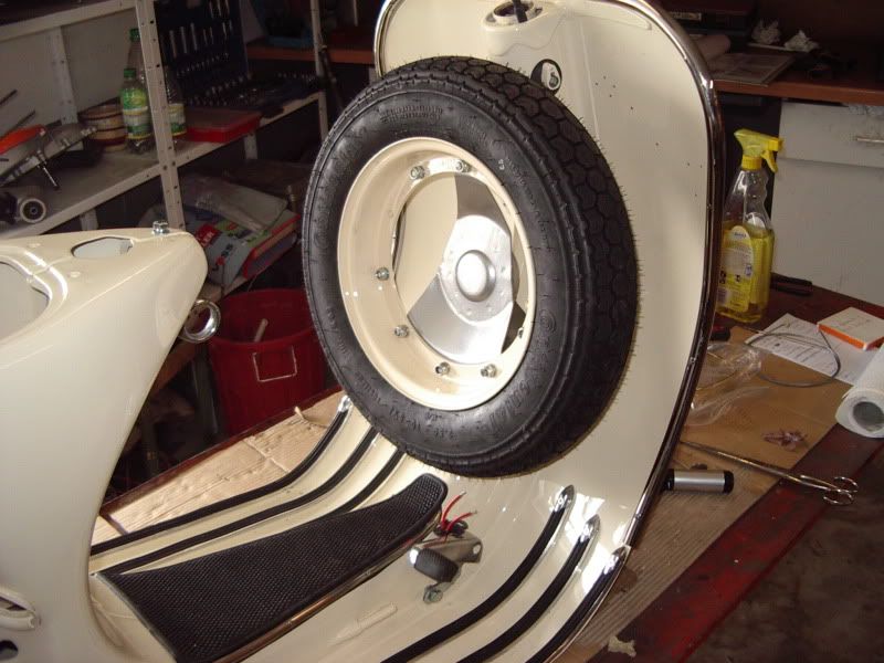

Floormat, Legshield Beading, Runners and Spare Wheel fitted:

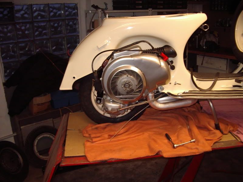

Got the engine in and wired up;

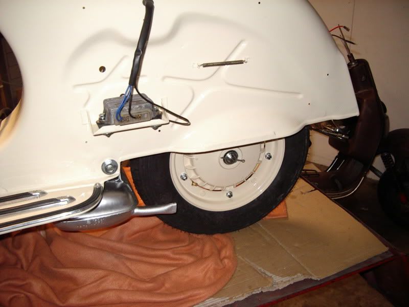

I Rubber mounted the regulator onto the existing holes in the battery tray;

The loom is extremly long so ill probably have to pull some of it back into the frame after wiring up the headset.

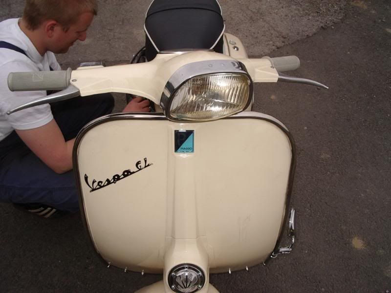

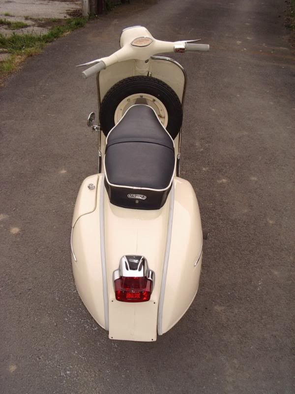

So, Finally finished and MOTd.
Heres a few pics........unfortunatley Im selling it, just got the news that my Employer is closing the doors at the end of the month ;(

just noticed you rubber mounted your regulator - I would have thought you would be better off bolting it directly to the frame to help earth it, and to help dissipate the heat it collects?
The rubber mounts are long enough to dissipate any heat and ive got a very good earth over the earth wire, (I checked it with a multi meter). Ive run this set up on a Sprint for years, havent had any problems till now.
I didnt fancy doing the usual mount under the tank just in case I need to work on it. Ive put it under the panel to hide it and give easier acces.

Thats why I wnet for a small block, the GL cowlings fit.
Ive also reused the GL Kickstart quadrant so Ive got the GL Kickstart on there as well.

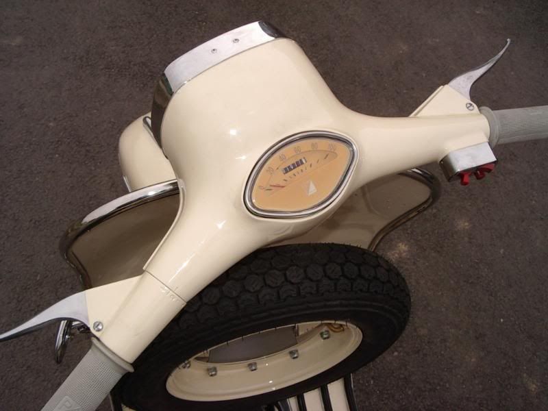

The only thing I dont like is the 12 volt headlight switch with its red buttons.....
