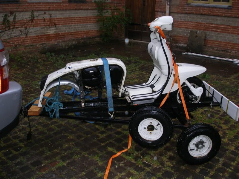

Here's mine, bought off Shocky, 82 Jet. Since that photo I have compeltely stripped it and had it blasted. I'm currently repairing panels prior to respray. It came with an Indian 150 but I am building up a 225 to put in it 8-)
