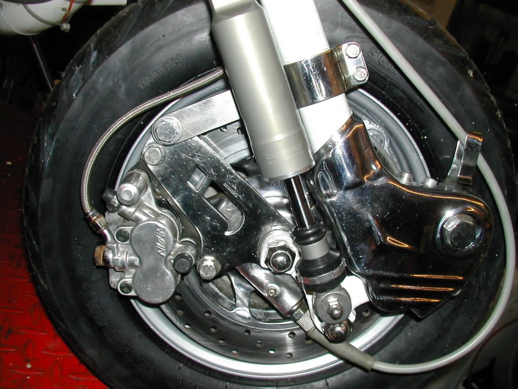

Fitted 2 upgrade kits to my 2 GPs on Friday afternoon, took all of 2 hours.
They work a treat too, well chuffed!

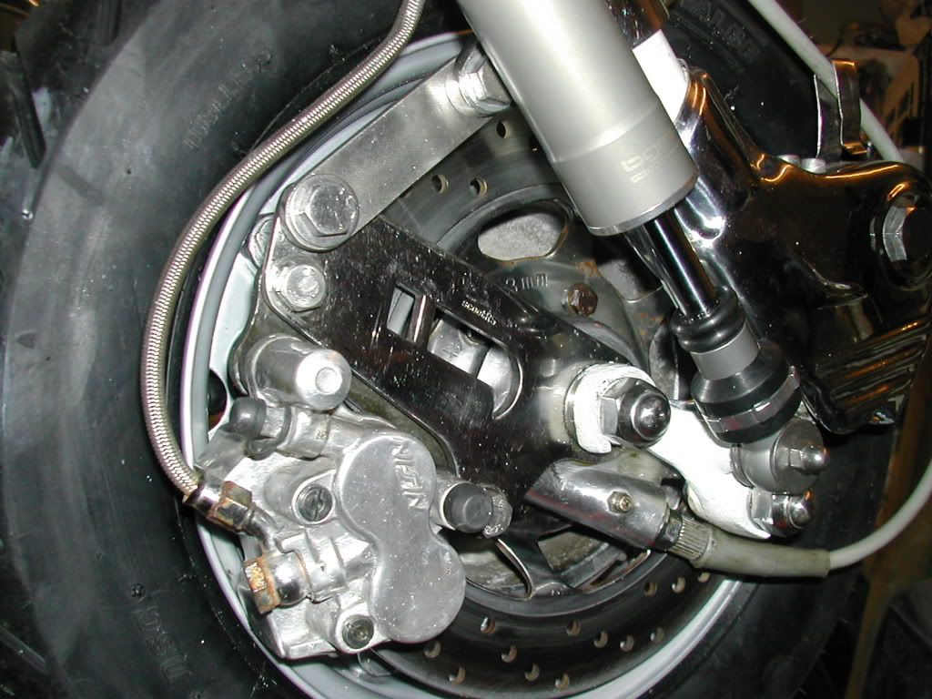

hi i finally fitted the upgrade and it works perfectly :D :D
heres a couple of pics
cheers steve
