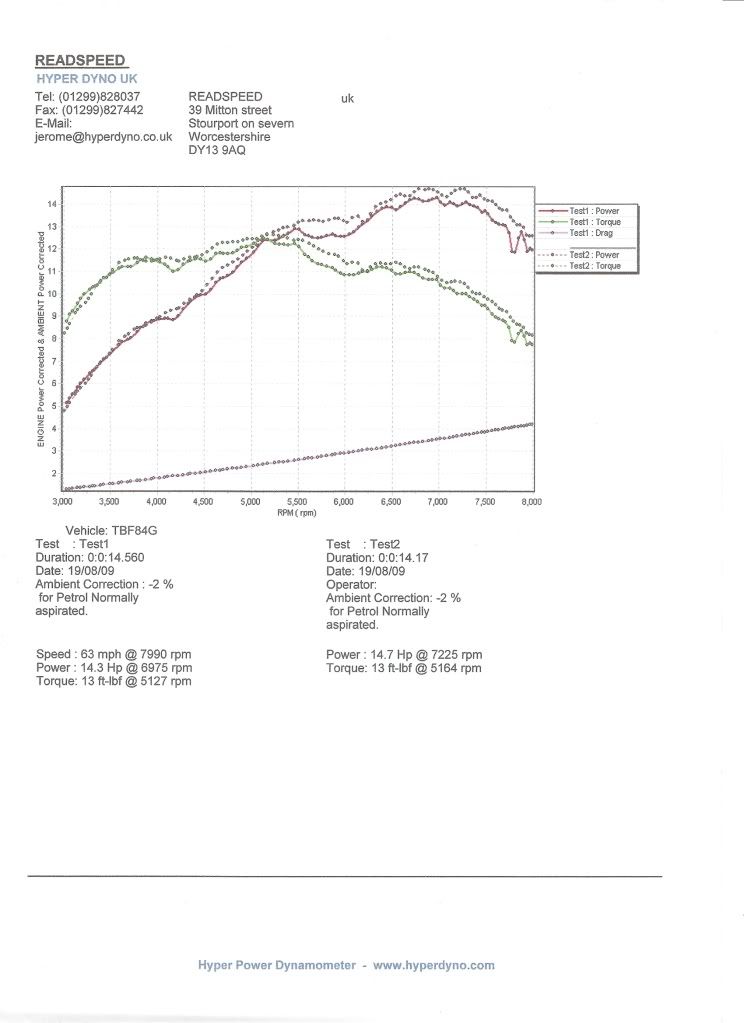

A bit slow and a little under powered by most peoples standards, but here's the 3rg gear run on Readspeeds Dyno, Before and after changing main jet to 125 from 128... AS I said earlier not as fast as it was when it was first built and Torque is well down on what it was when new... The bore is starting to wear and the rings went in at near to 19 thou when replaced last time... The original rings were gapped at 11 thou when new when the kit was new... the scooter still sits at speeds upto 70+ but not as strong as it once was.. :cry:

Hi m8 nice to see std graphs as you say, gives a good picture of what you start with and work from.
