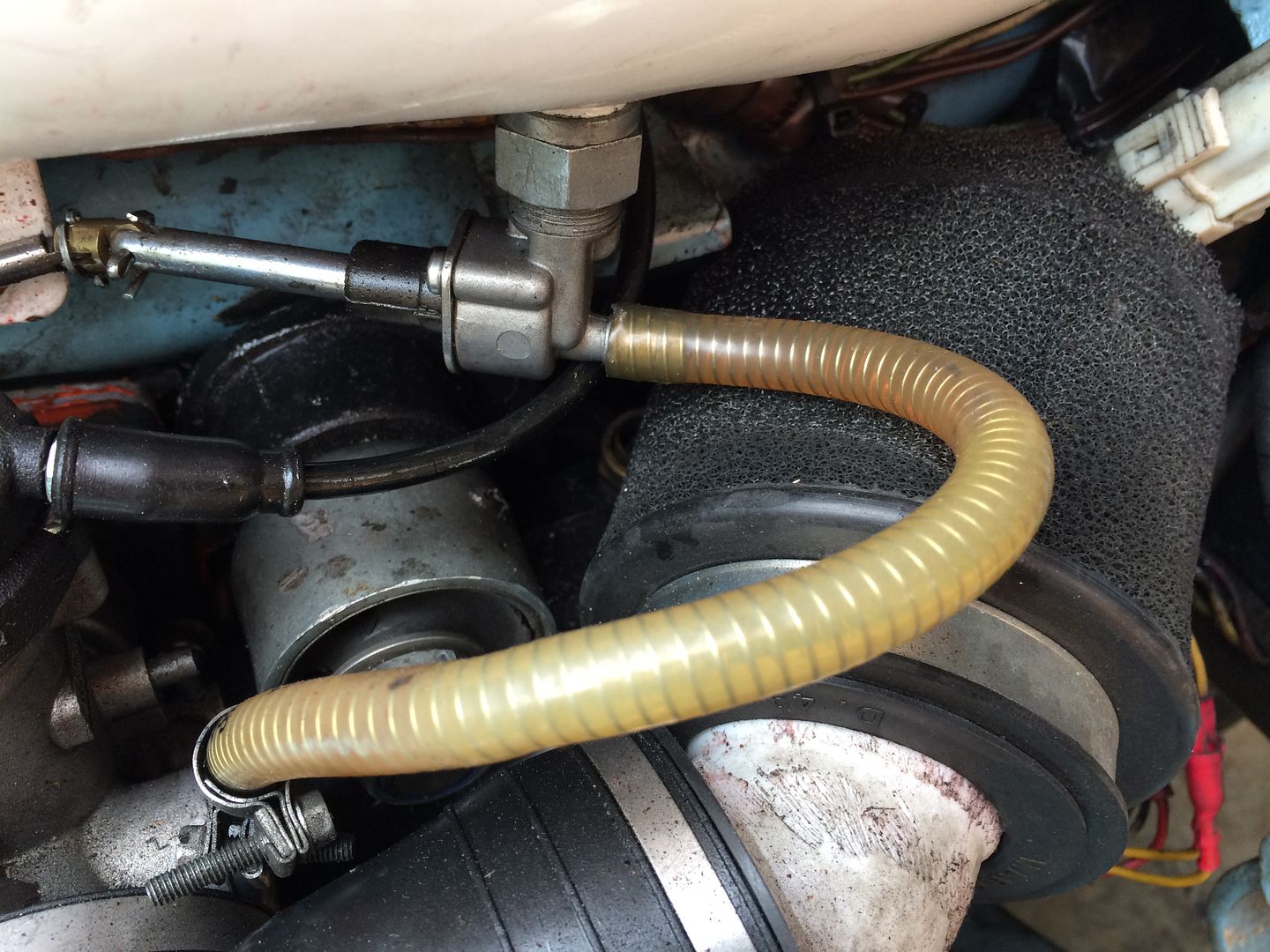

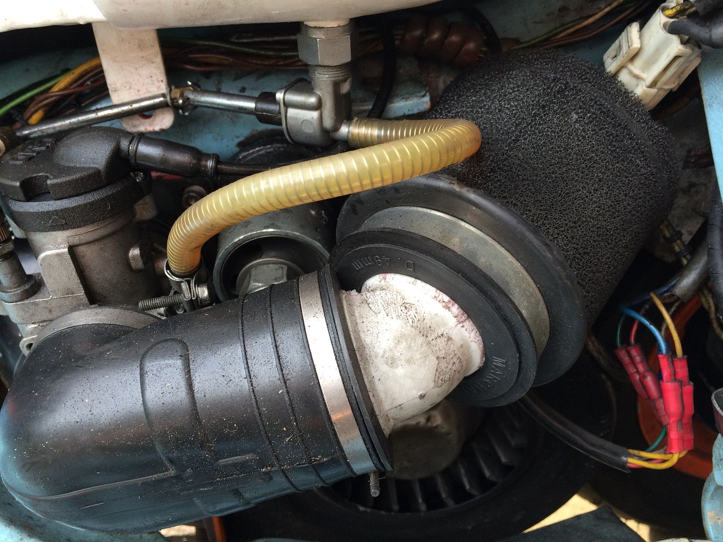

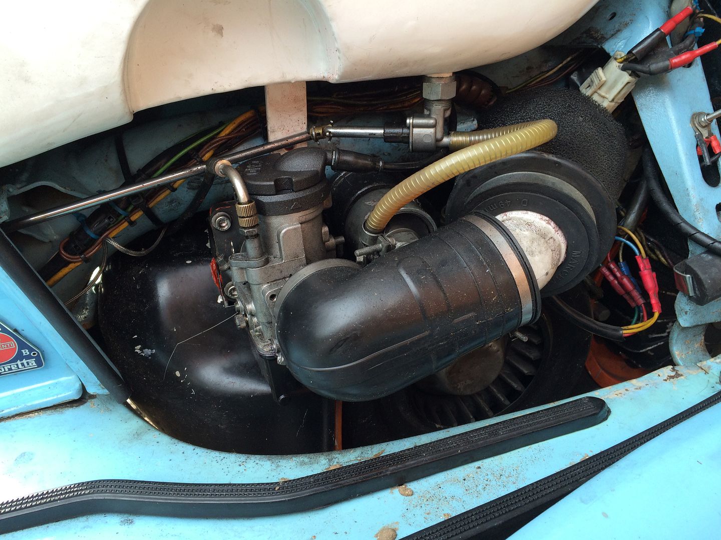

As promised:

coaster wrote:As promised:
Coaster many thanks for the pics. What is squashing on mine is the rubber elbow not the foam filter. I can see yours is further back referencing the runners, mine is further out over the top of the inner runner. It must be that the atomic reed valve is longer than standard manifold
Mine has also has an Atomic reed valve but it's the Ultimate version, don't know if there is any difference in the protrusion :? Also as mentioned, my rubber isn't symmetrical, it can be reversed so that the mounting faces backwards slightly which helps. My rubber is held on with 4 allen bolts, I thing the smaller RS manifold has only 2?
