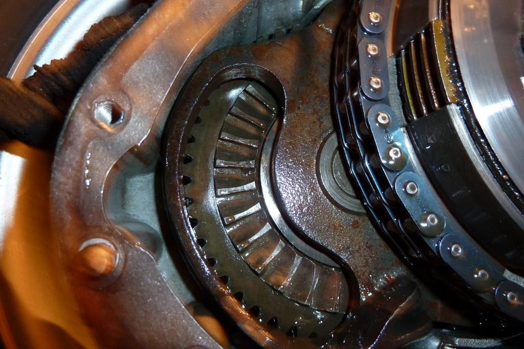

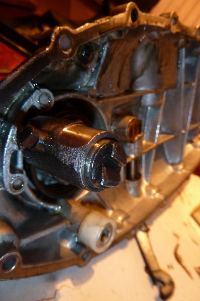

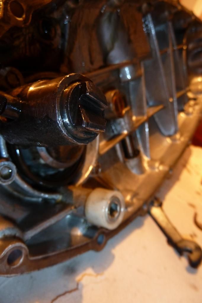

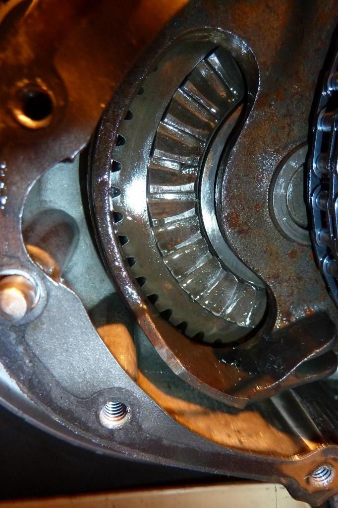

Here are pictures of the 1st gear and plunger. I've not had cause to look at these in detail before. Do either look excessively worn?
I get my kicks out on the floor.
The 'pawls' on the piston should be sharp, yours look rounded and some of the teeth in the 1st gear look a bit ropey too :( I'd go with a new good quality piston and see if that improves it. It worked for me and I only used a cheap piston off ebay (my 1st gear teeth were also worn). Another thing working in my favour was that I used a Tino Sachi kickstart shaft which I noticed had the circlip groove that retains the little plate that the piston return spring butts against about 10mm further up the piston which increases the spring pressure pushing the teeth into the gear.
