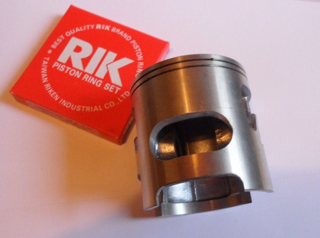

I did a piston like this on for a guy in Southampton.
The cut out has to be central on the kit pistons as the inlet side of the piston is NOT thicker like a TS1
If you are going to get a new type invisible "Clubman" :roll: use a 4.8:1 gear ratio
The picture is not a Kit piston
