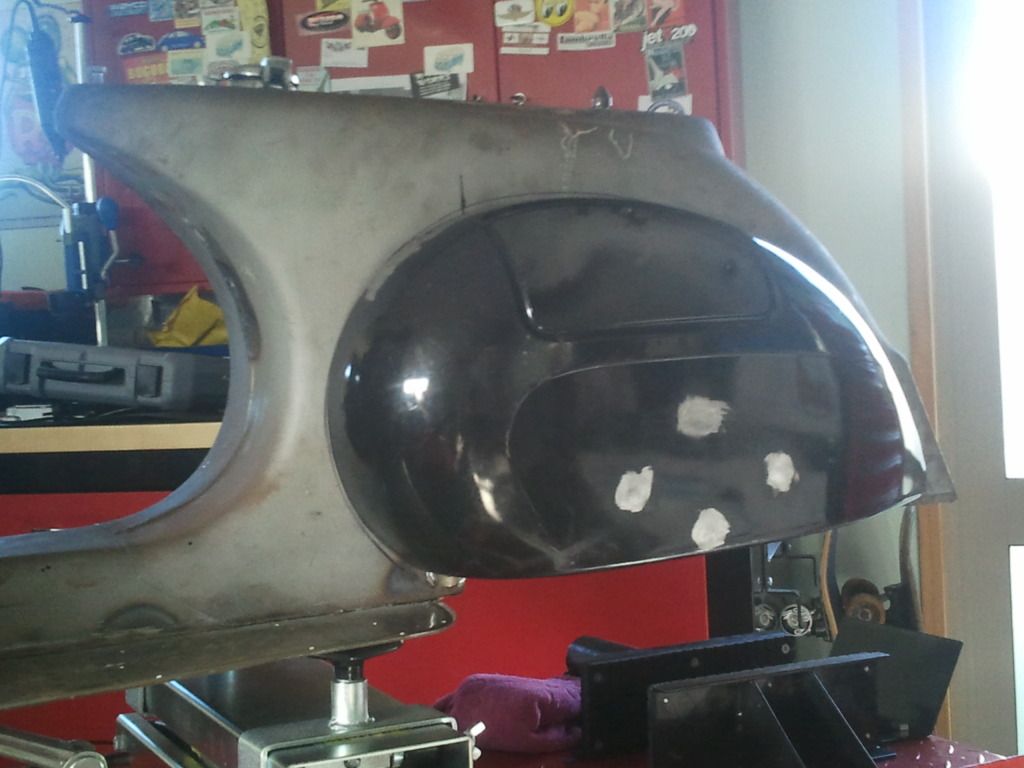

Finished remounting the LH side pod so the Glass tank will fit in, Next weekends job glass in all the fitting into the tank and get it sealed up.
That's going to be stunning, some very nice touches, I'm impressed.........but not as impressed as I am with the plasma tv on the workshop wall, I like your style 8-)

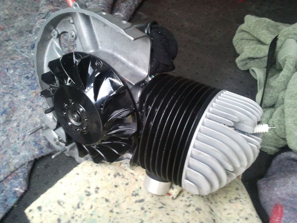

Got the
engine back from Retro Scooter Today(Thanks Kev and Andrew!)
Fitted Gransport piston and Mallossi upgear fitted + Vitron seals
