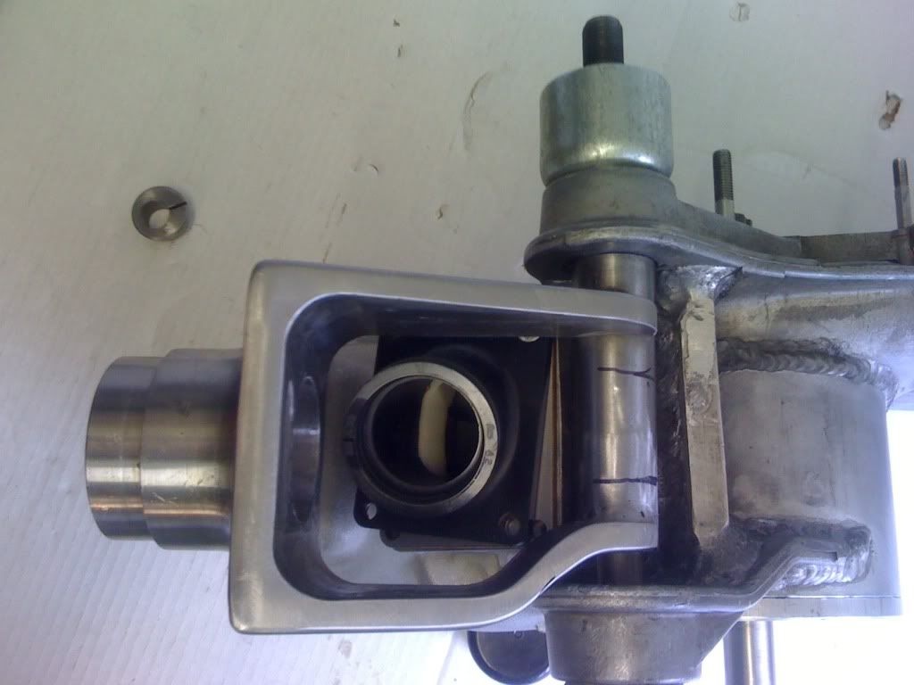

With the room that it has above the barrel will it be fitted with a down draft carb straight above the inlet or a long manifold and a carb. The down draft would be better for performance and less work.

this is the new engine bracket rocho has machined to mount the engine,the mark
is where the bracket will be cut out for the carb
That is neat.
Chris CSPE wrote:With the room that it has above the barrel will it be fitted with a down draft carb straight above the inlet or a long manifold and a carb. The down draft would be better for performance and less work.
perhaps one like the dac bike used ??

the engine bracket on the engine showing the cut out for the carb,

so long as your happy, but slugs in my opinion and experience should be hollow, similar wall thickness to the tube your joining, and ideally about 1.5 times the diameter in length
some nice work going on there, I look forward to seeing more of it

tonydevon wrote:so long as your happy, but slugs in my opinion and experience should be hollow, similar wall thickness to the tube your joining, and ideally about 1.5 times the diameter in length
Hi tony ,yes its hollow and the same thickness as the tube
Cheers lee
