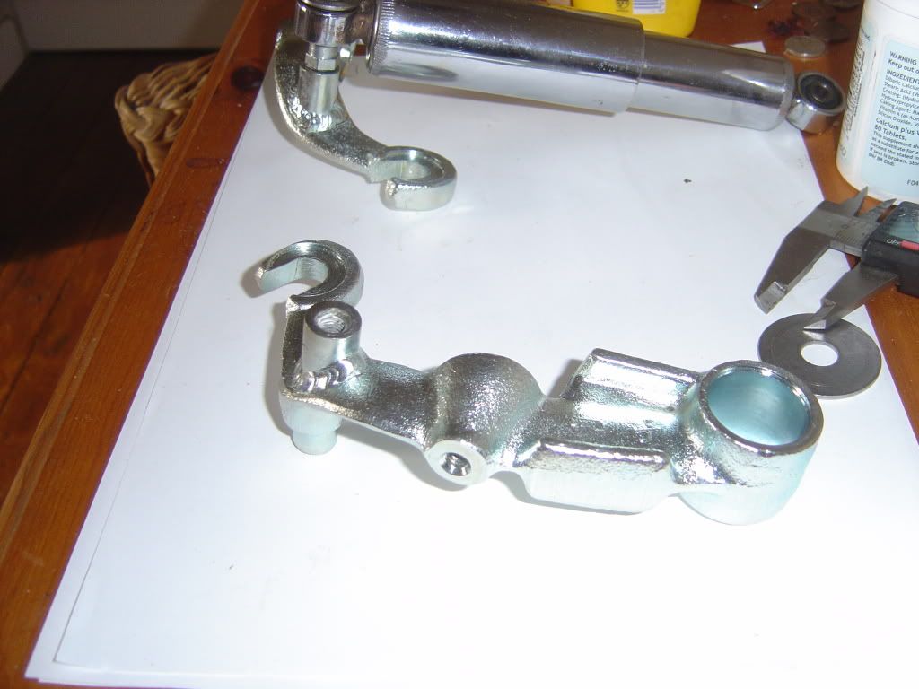

genuine sil ones seem ok to weld other non stamped indian ones i wont do the SIL ones dont replate as well as the spanish/italion ones there better of being sprayed or powdercoated
heres some ive just done for a forum member
i make very little out of these and i make no money from the replating (it cost me time to take them there)

I have drum links on my LiS rebuild -- was going to replace so I can fit dampers.
Is there any reason to suspect that old (original) links that have been standing around for 25 years+ would not now be upto the job if they were modified like this and replated -- fatigue or anything else like that? Maybe I worry too much.
Devlam wrote:I have drum links on my LiS rebuild -- was going to replace so I can fit dampers.
cant say as ive had any problems or been told of any problems with any of the 200 plus sets ive done over the last 10 yrs
