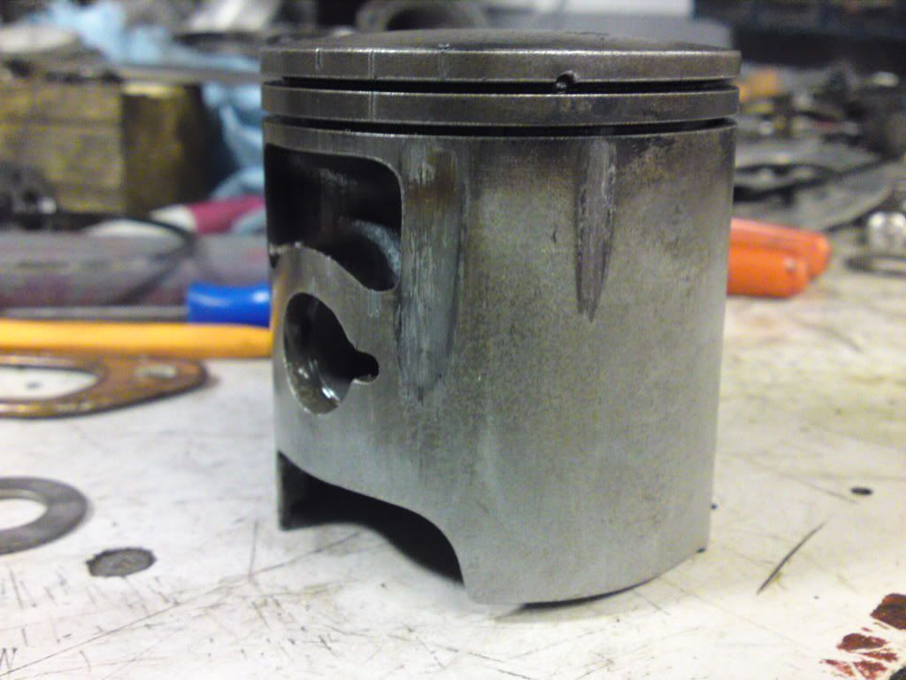

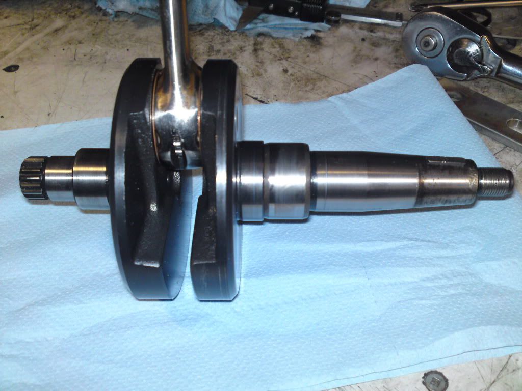

I HAVE JUST REMOVED THE CRANK TODAY AND AFTER CHECKING ALIGNMENT DISCOVERED IT WAS RUNNING OUT 0.30mm.
the crank looks in good new condition and little miles on it although the piston had a few minor scuffs!!!!!!!!
SO CAN ANYONE IDENTIFY THIS PISTON AND WHAT CAN I DO TO REPAIR IT??
will this crank always be problematic??
thanx in advance.
the piston is stamped ART inside with 1/2 and is 66.8mm is this a honda or pattern?

.3mm out of true is over 10 thou " out. Thats very twisted. Where did you measure it mate?

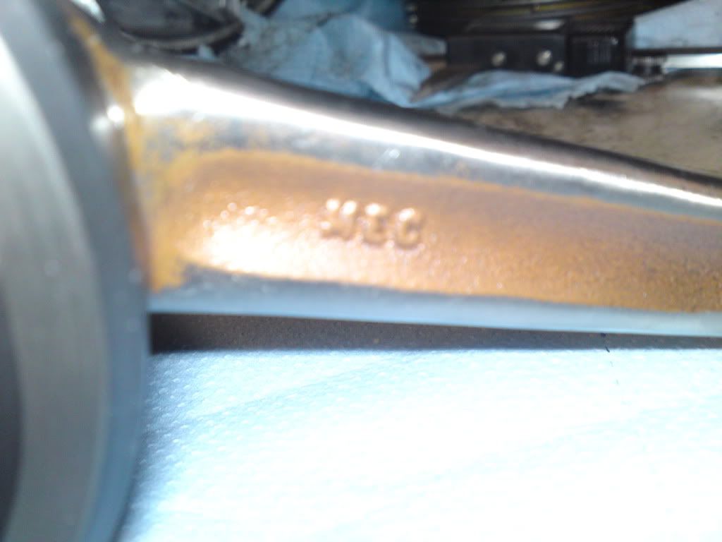

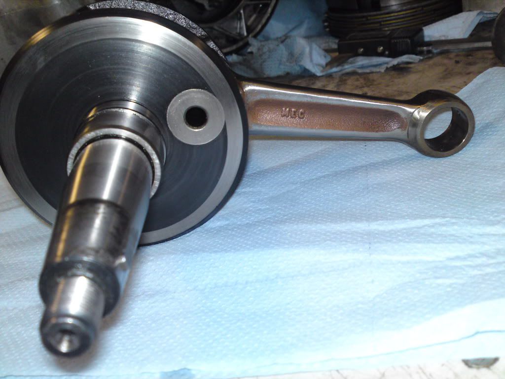

I've found MEC cranks very good value for money but |I've never fitted one in anything fruity without having the pin welded.

Measured it at the furthest away point from the center end of flywheel taper!!!.3mm run out on the v-blocks,,,, at the web it was .2mm so pretty bad,, i,m quite surprised as it seems a good quality crank with strong conrod and beefy webs and taper but obviously not so good a big end pin fitting!!!!!

mec cranks are the best on the market by far for the money - the pins have a much stronger interfereance than the others on the market in the same price range.
if you havent damaged it - there will be no need to "retrue it"
the reason clubooks crank is out is he has repeatadely seized his engine forcing his crank out of true
