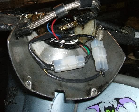

I don,t use the bulb holder as a junction box at all. fit some decent connector blocks instead.

byron wrote:I don,t use the bulb holder as a junction box at all. fit some decent connector blocks instead.
Good idea! got any pics of yours?
here you go :
Dryballs
Posts: 333
Location: Stockwell, London
Nice one... Add that the the of ideas to copy!
Makes things a lot simpler doesn't it!
