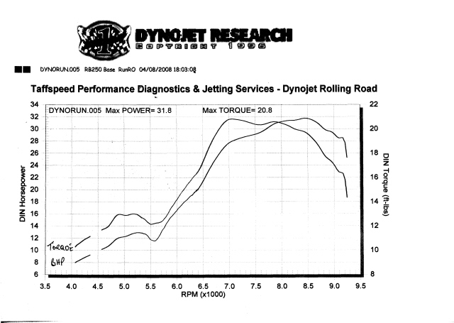

So we are all talking about the same thing and to answer your first question (care of wikipedia)
Torque, also called moment or moment of force is the tendancy of a force to rotate an object about an axis, fulcrum or pivot. Just as a force is a push or pull, a torque can be thought of as a 'twist'.
In more basic terms, torque measures how hard something is rotated. For example, imagine a spanner trying to twist a nut or bolt. The amount of 'twist' (torque)depends on how long the spanner is, how hard you push/pull on it and how good you are pushing it in the correct direction.
What we call in Wales ' Grunt', it's not top speed, how many cc's or BHP, its how quick you get there, the force trying to lift your front wheel, pushing your arse down the seat, what makes your pillion grab you around the waiste.
A usable range over 2500 - 3000 revs, this is my Taffspeed RB 250 with a Franspeed JL3
I can be a lazy rider, it pulls from 40 mph in fourth so I don't often change gear.

thanks so far folks,for posting up your results
just what i expected .
greater torque is to be had from higher revving machines than say ,large CC lower revving set ups,which most folk assume should be for some strange reason more torquey..
