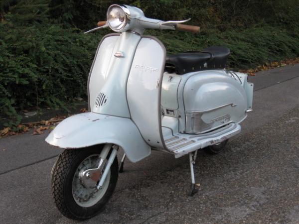

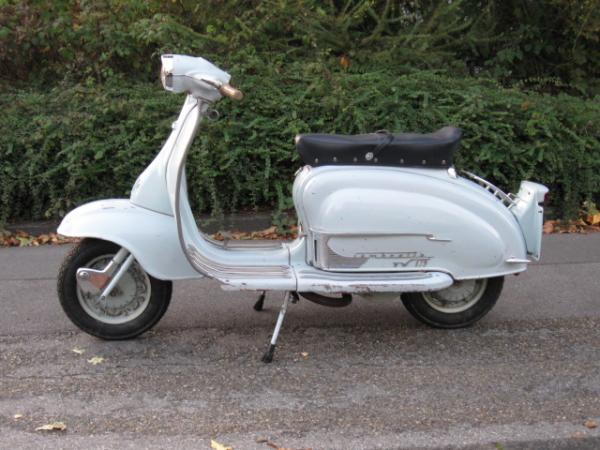

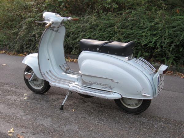

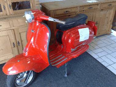

heres a stunning example of a german export-model series II tv175.
(its an early example without indicators.)
it was found on an "auction for everything" , beeing oversprayed in red 20 years ago or so.
all in all in ok condition, the new owner treated the whole scooter with graffiti-cleaner and fine wet sand-paper...
the new owner says that thinners and graffiti-cleaner can be too agressive on some scooters, so try it on non-visible areas first (frame, inside horncasting, etc..).
before:
after:

I'm wondering if thats actually the same scooter. The second picture shows an original stand and grips amongst other things..
firekdp
Posts: 706
Joined: Wed Jan 07, 2009 12:02 pm
Yes, the grips and stand have been changed, but look at the damaged paintwork on the front mudguard, legshields (below & to the right of the badge near the trim) and other places they're in exactly the same place before and after.
Soulpunk
Posts: 305
ok, grips and stand might have been changed.
but not bad adding used grips to this scoot...
