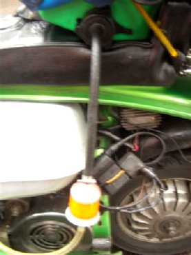

Hopefully you can see the photo if i've done it right!! The bodge was done on the way to the Euro in Germany by Woody from the Lambretta Club of Scotland. The threaded part of his petrol tank split from the tank so he got a plastic petrol can bungeyed it to his seat and made a hole in the can, pushed a biro into the hole and connected his petrol pipe to the biro!! It got him to Germany and all the way home!!

PJF wrote:Hopefully you can see the photo if i've done it right!! The bodge was done on the way to the Euro in Germany by Woody from the Lambretta Club of Scotland. The threaded part of his petrol tank split from the tank so he got a plastic petrol can bungeyed it to his seat and made a hole in the can, pushed a biro into the hole and connected his petrol pipe to the biro!! It got him to Germany and all the way home!!
I like that a lot.
Almost like one of those Tracheotomy ops!
