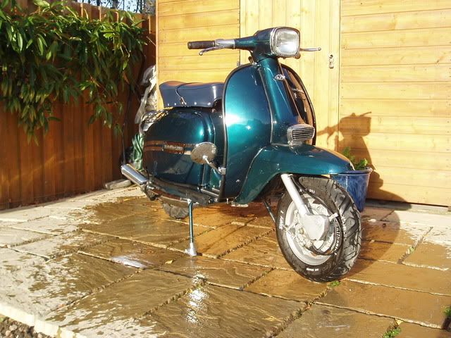

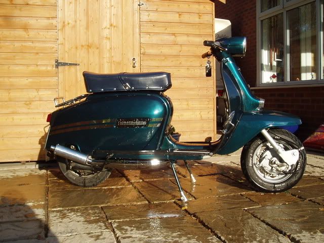

Here are some more photos of my scoot. Finished off fitting her new exhaust today, after carrying out some repairs. The exhaust studs had vibrated out and the threads had stripped.. I ended up fitting 8mm studs instead of the normal 7 mm. I had to drill out the exhaust flange bolt holes just a tad to make fitting a little easier. The exhaust itself is a Scootrs pipe and was bought from Resurrection Scooters in Burton on Trent for just a tad over £100. Performance wise... Much better with this pipe fitted. Tons more mid range power and pulls like a train.
