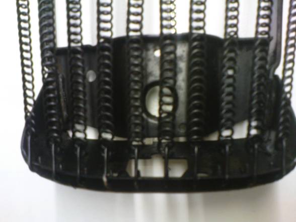

Can someone identify this seat and which catch is needed? Any pictures of the catch needed would be much appreciated as would anywhere that sells them

another image

Looks like the Serveta one which had a catch akin to the Vespa one????
Soulpunk
Posts: 305
its the first type of a serveta lince seat : springs, rear p-range lock, "lambretta" printed in white over lock on back.
it locks in a p-range-pin. but pin must be higher mounted. originally its a p-range pin welded on a tin-subframe which is screwed on the frame on the 2 original holes.
cut a little piece of steel , drill 2 holes, weld a long cylinder-stud m8 in the middle and screw a
p-range pin in it...
try totally scooters first. they have a wide range of serveta parts.
or try allstyles scooters. they also might have it.
(but make shure you get the correct one of the 2 variants)
