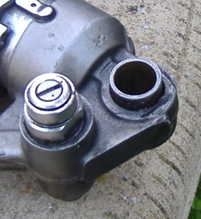

leaving aside the discussion around whether an R1 shock is suitable for a Lambretta, if you are going to use one [and I do] do fit some decent bushes, so not like these :
the top one was totally off centre and had a bit of rubber wedged around halfway, the bottom one was just steel. And this was on a scooter that allegedly has had £10,000 spent on it... :shocking:
new bushes ~ thanks shocky, excellent service ~ now fitted, with spacers made up to fit behind the shock.
