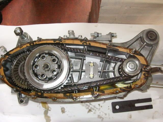

This is how the motor looked inside when I first took the side casing off - it was a NOS, late 125 motor - look how clean the oil was !

Here my 175TV engine:
