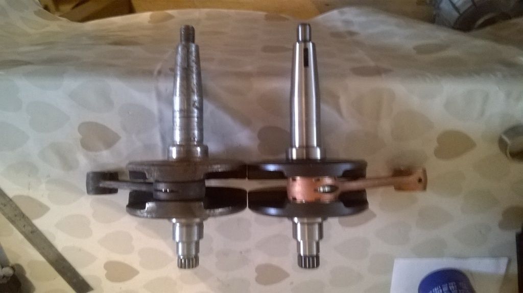

i can only assume someone in india replaced the roller bearing with the equivilant caged ball bearing
Nelly001
Posts: 18
Joined: Tue Aug 30, 2016 12:54 pm
Main scooter: Gp150
sorry bearing measures 15mm same as nu2205 not 18mm
Nelly001
Posts: 18
Main scooter: Gp150
seems as if i have received the wrong bearing from scootopia they sent me a nu205 instead of a nu2205e which would explain why its the same size as the old 1 .i got a nu2205 on its way so hoping this solves it.in my defence there were no markings numbers on either the new or old bearings .
