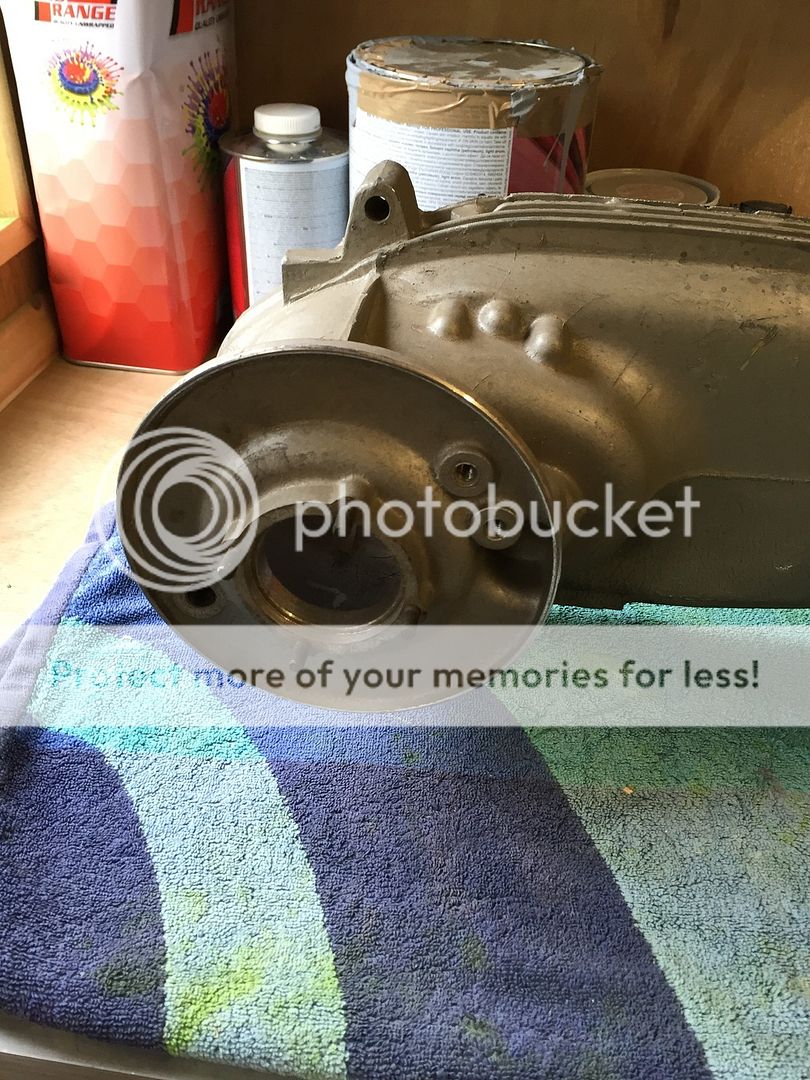

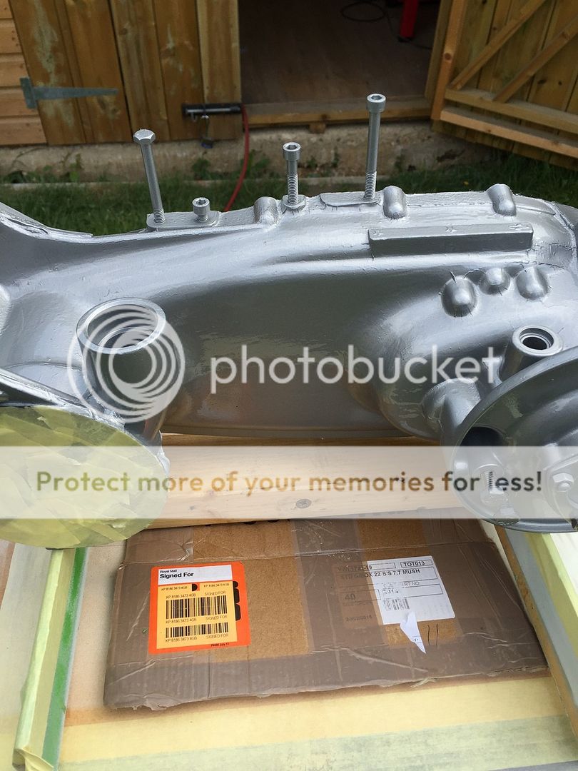

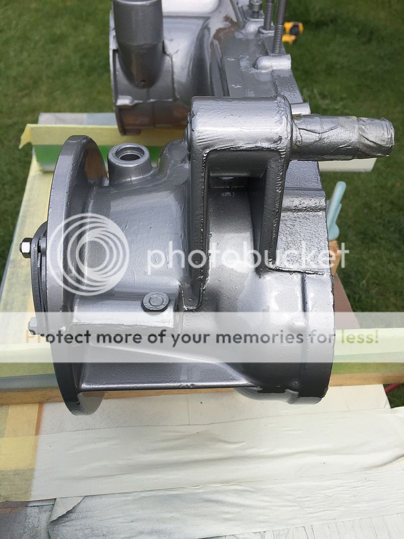

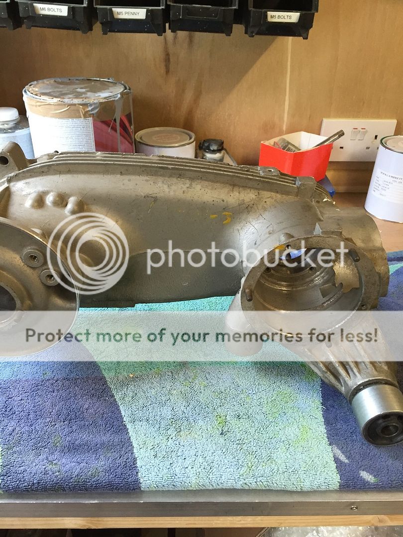

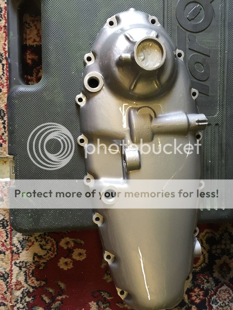

The Indian casing I'm using is as rough as you like. I plated over all the gasket faces and popped it in my blast cabinet. Once blasted it was a lot better. A quick prime top coat and several layers of lacquer it looks a lot better.
Once it's had 48 hours to dry I'll start building the motor up. More pictures to follow.

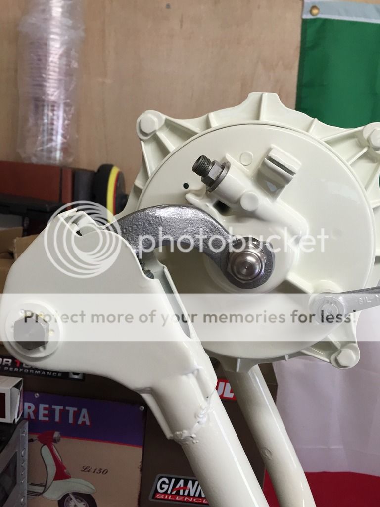

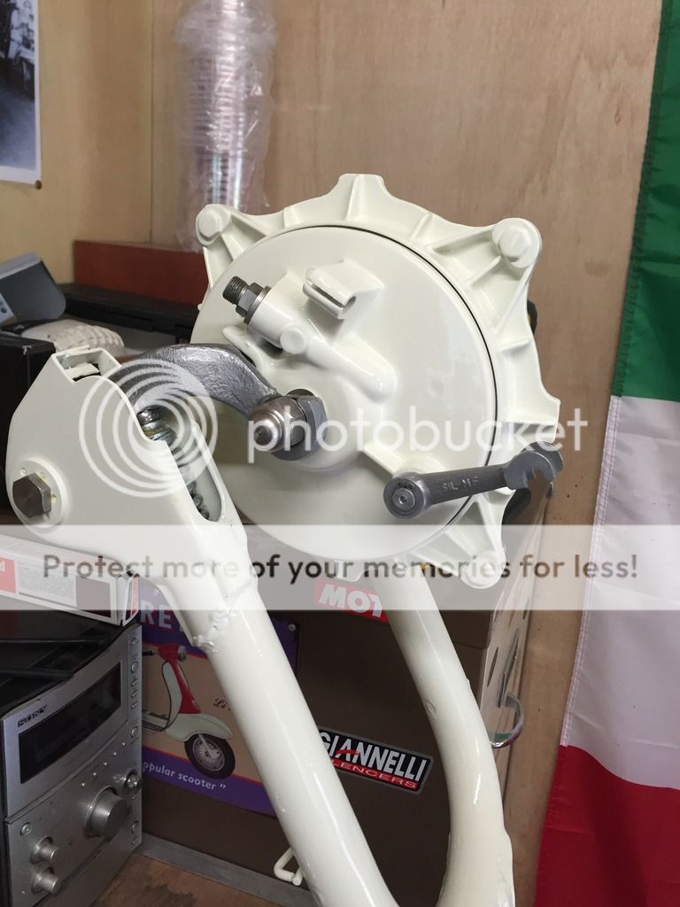

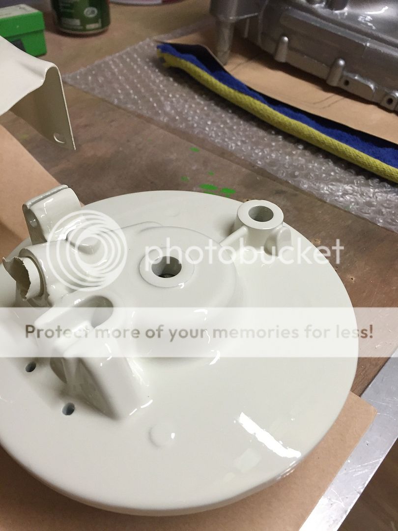

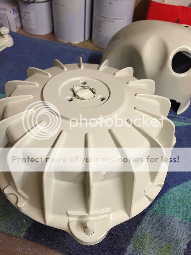

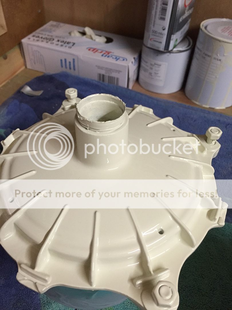

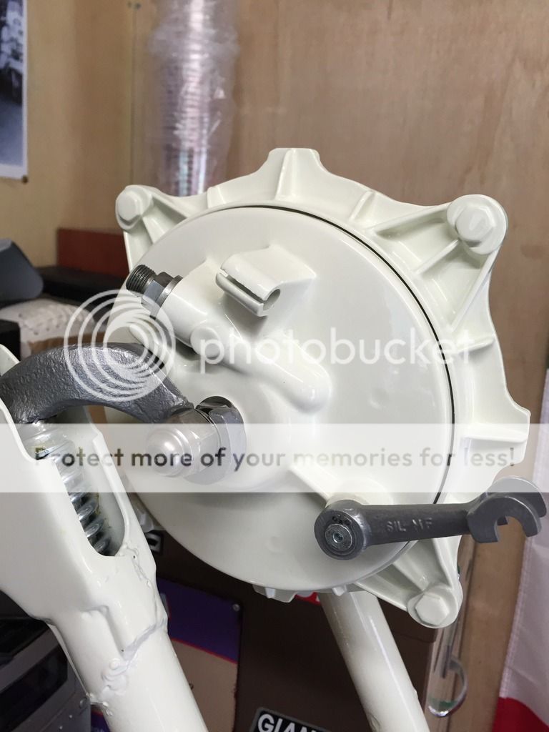

Rear and front hubs painted today.

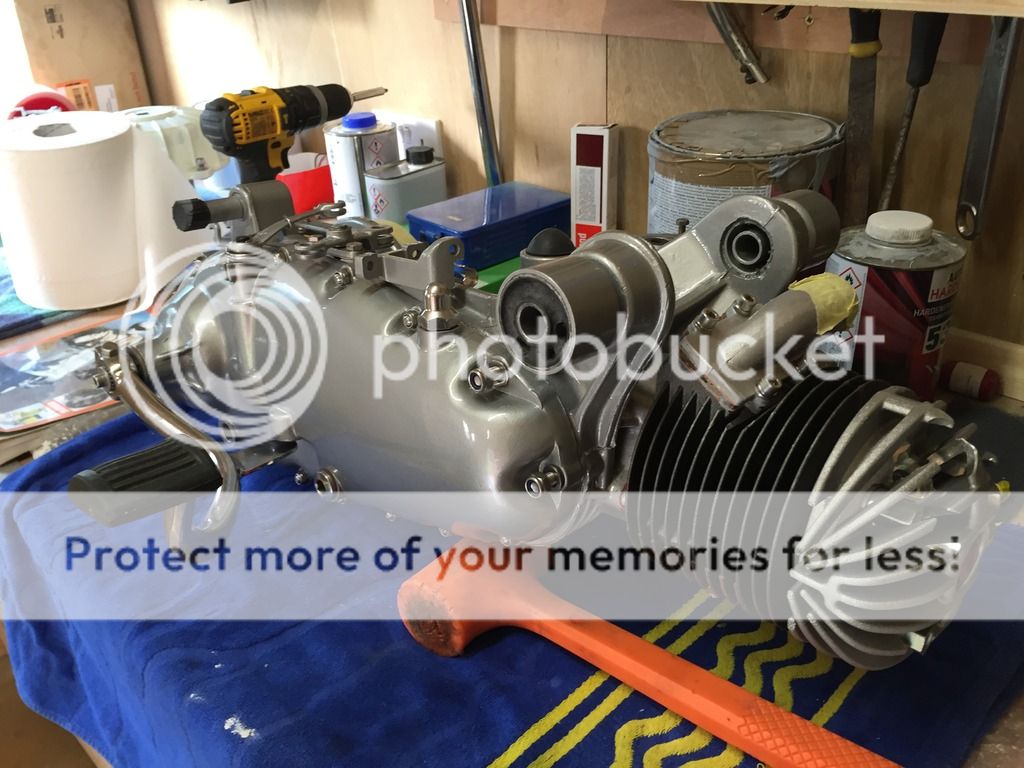

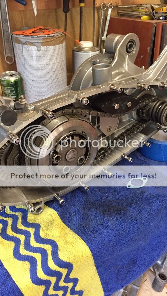

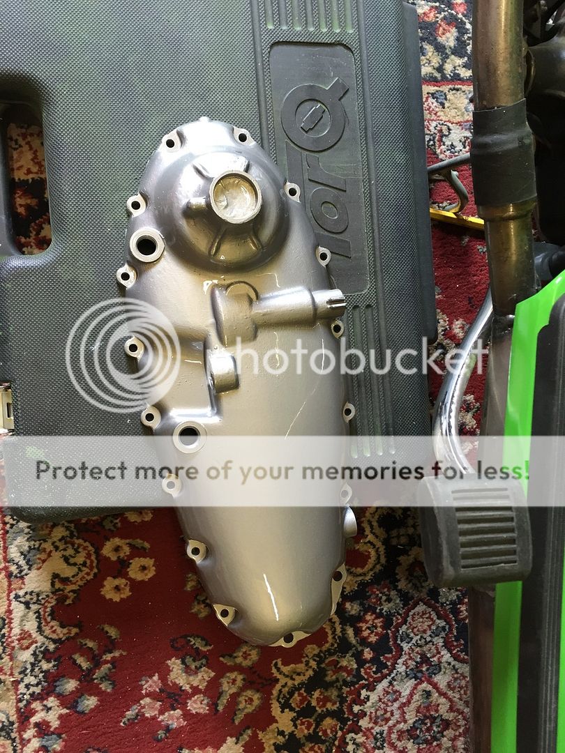

I've managed to get a few days in the shed, so I've started putting the motor together. The crank was an absolute pig to get the inner track bearing on, even with 3 days in the freezer, and a blow torch! Other than that it all went together smoothly.
I modified the side casing and fitted an LI ramp, rather than the end plate ramp. This is a very worthwhile modification and well worth doing. It only takes 15 minutes to do.
More pictures, as I progress.

I've now built the engine. The GT top end was a treat to put together with Rich T supplying plenty of various thickness gaskets to help set a squish of 1.2mm.
I've also painted the forks and fork links and assembled and fitted the front hub. As I used all the original cleaned up parts ( apart from fork internals ) both went together very easily.

hi 10inch i think i would put a tab washer on the pull down tensioner just to make sure
10 inch Terror
Posts: 1447
Xbox live gamer tag: No.
garry inglis wrote:hi 10inch i think i would put a tab washer on the pull down tensioner just to make sure
Before I close the casing up, I did remove the bottom screw and fitted a loctited stud and nyloc nut. Cheers mate.

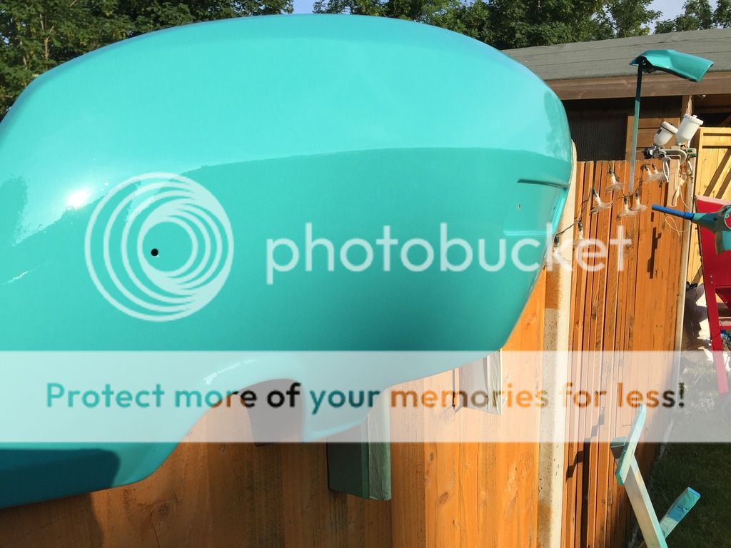

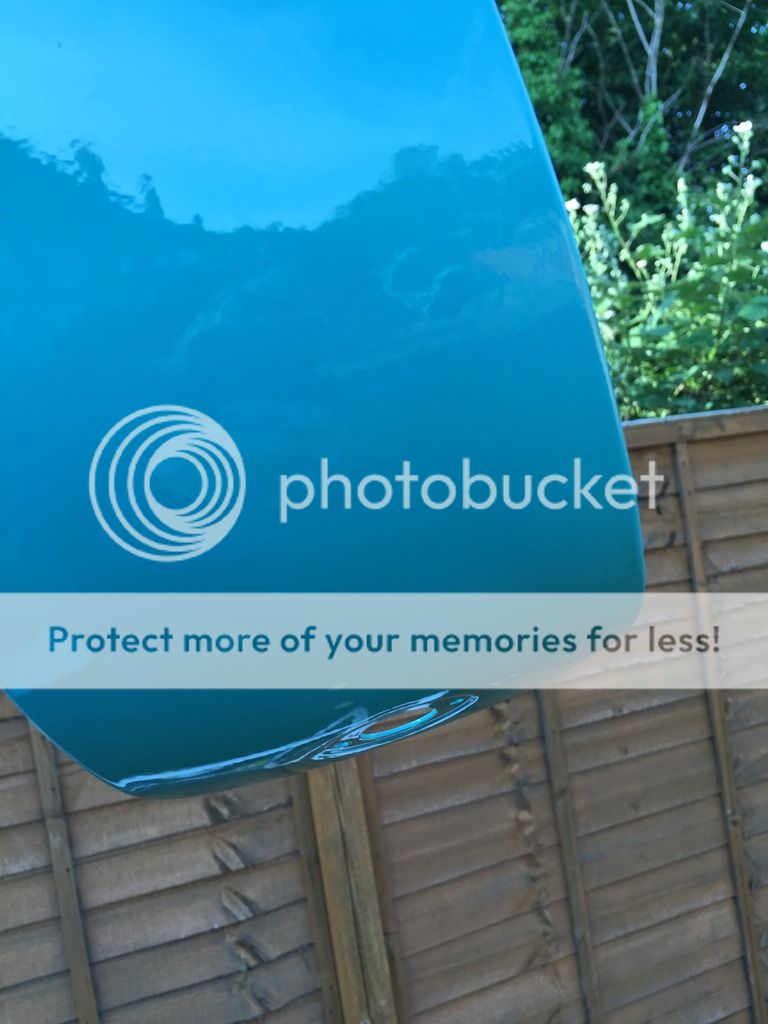

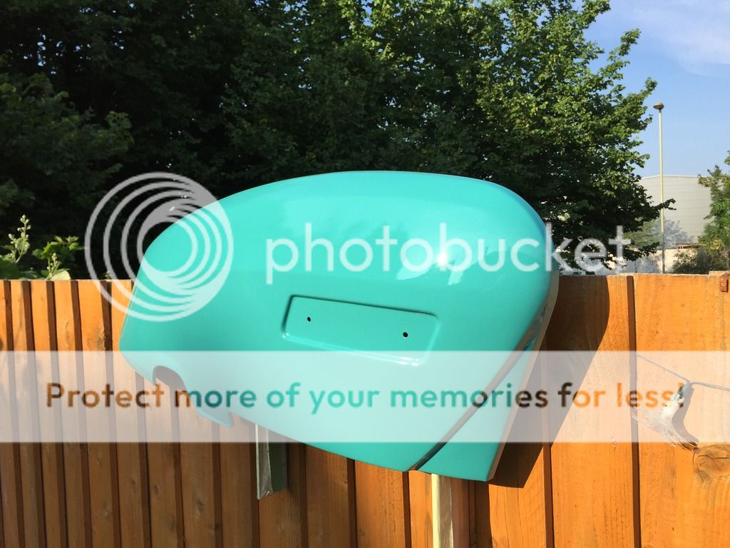

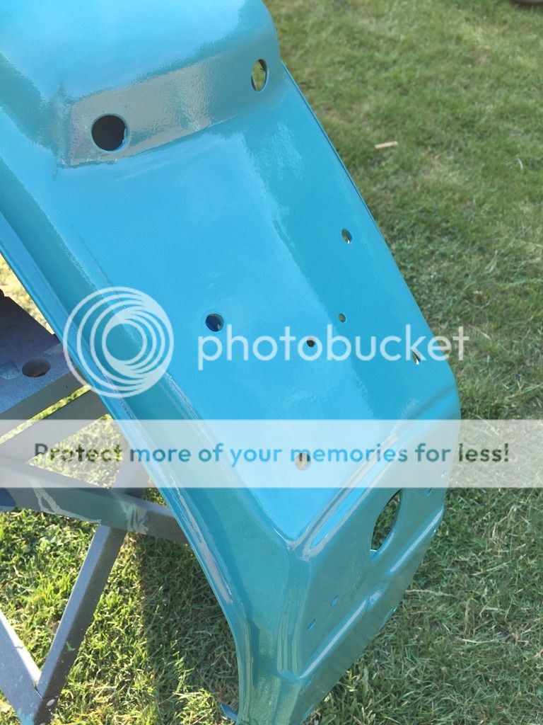

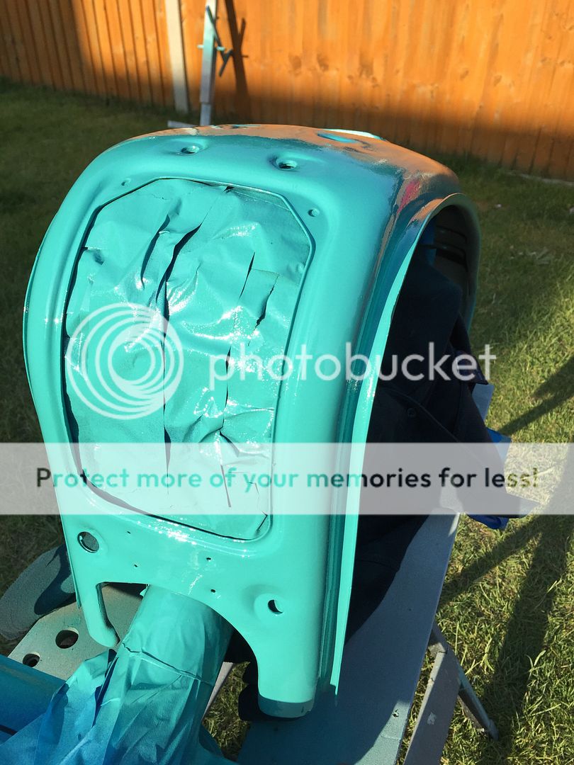

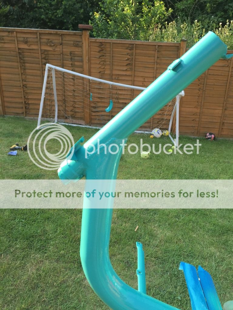

I've managed to get a few more bits painted over the weekend. The frame, toolbox door and side panels. I'll give it 48 hours and mop polish it all. I'm getting there now.
More pictures as I progress.

I love the colour , should look sweet when all done :)
Padge
Posts: 117
Joined: Sun Feb 07, 2016 10:08 pm
Main scooter: 1969 Lambretta gp
is it proper lechler 8016 turchese ?
bet the kids love you, looks like you broke the goal posts hanging yer parts on it !
