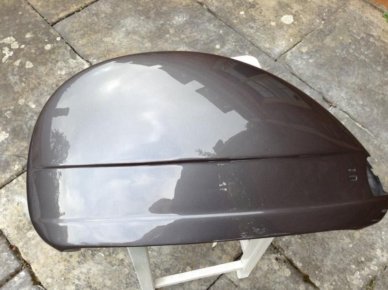

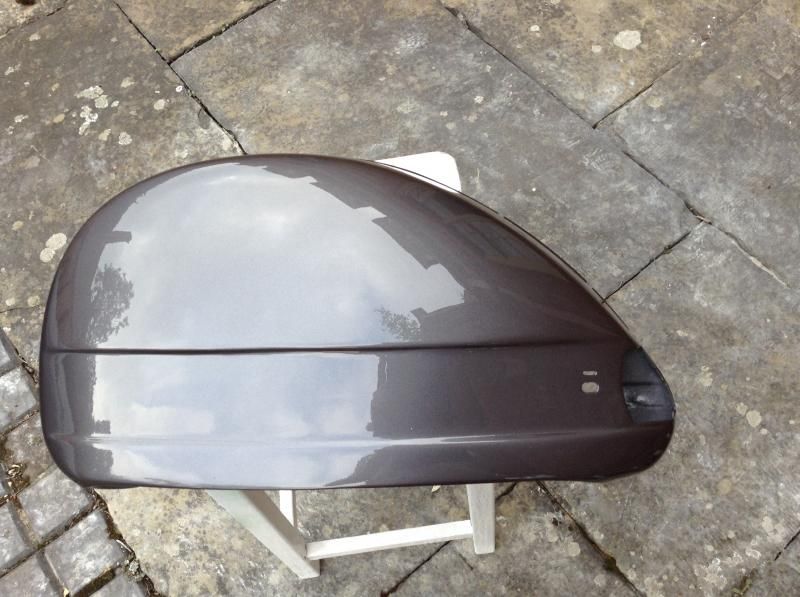

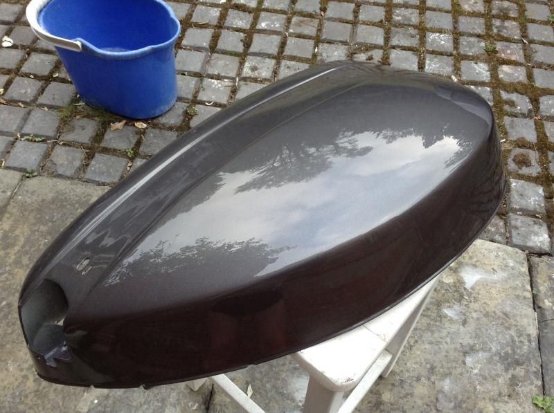

As said, the cans have an device on the bottom of the can which releases the activator into the lacquer. I used one from an ebay supplier and it was fine, managed 2 coats on a PX side panel and 4 coats on the PX headset cover. According the blurb on the can, the 'working time' was dependant on temperature so I put it in the fridge and found it still usable 2 days later 8-) All hardened off now and a cracking smooth finish, the photos are before polishing, no orange peal at all:
