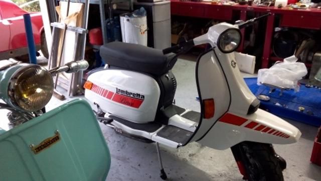

first legshield/ MG trial assembly.

seat back from the restorer shop:

elb1
Posts: 42
Joined: Sat Jul 26, 2014 5:08 pm
Main scooter: eibar s2 li150
Location: Oldham
Looks very comfortable think you will be happy doing some miles on it . Really enjoyed this build its been educational. I will have a tinge of sadness when its over although I can't wait for the dyno run!! :lol: cheers
Snapper
Posts: 12
Joined: Sun Mar 02, 2014 10:34 pm
Main scooter: Vespa T5 Classic
Personally I can't wait until it's finished...let me know when it's done mate and I'll hop over to Paris and pick it up in person.
...you are building it for me, right FF?
Heh heh, seriously though mate...the scoot's looking fantastic! :D

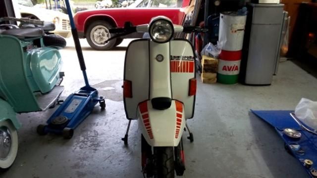

news from the Lince lair
Some like it not but I do!
Still missing the legshield toolbox. The Lince must be ready for tomorrow Moto légende exhibition.....

guygrrr
Posts: 119
Joined: Wed Jan 21, 2009 7:18 am
Main scooter: 1980 Vespa P187
Location: Philadelphia
Thumbs up! She's a beauty!
