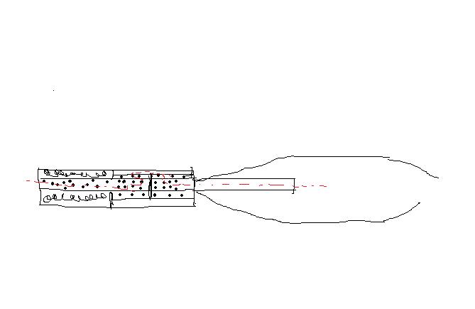

here is a very rough and ready pic of what i remember the mickek insides looking like.. i have tried to do it as a cross-section.. as you will see there is a 'block' about a third of the way through the silencer which fordces the gasses in and out of the concentric tubes before it goes through the final bit.. its also worth noting thet the silence tube (or 'stinger') actually finishes inside the chamber at the point of the start of the reverse cone. incidentally the red marks indicat the gas flow :D
wow thanks for taking the time to do that lofty, really useful, and means that I need to put the drill away... because that "block" is where mine is...
hmmm... that might explain their characteristic sound...
there is a small hole in it now, I can run a gear cable through the pipe...
think I'll sling it back together, only padding the final section and see what I can rev to...
