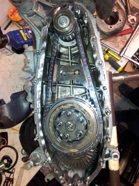

The engine took three goes with a steam cleaner to get it clean.
But after it was cracked open all looked good inside :D
Apart from the split link in the chain, need new rings ( but still good 66mm bore) and the clutch sprocket is marked Innocenti ?

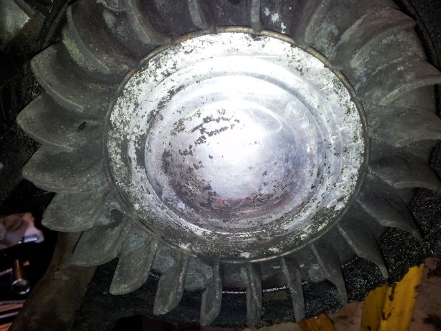

The flywheel had a strange dust cover and the circlip is grooved into the fins ? Its a Motoplat electronic ign.
So the plan was a std engine, SX crank, motoplat ign. but with a 22/26mm carb and a box pipe . Then when the GT kit comes out, fit one of those. The main priority was to use the Motoplat ign and hope the crank would cope with the GT kit. I would normally just fit a GP crank as a matter of course.
All this is now up in the air, as ive just discover why the flywheel was rubbing on the stator :? theres a crack along the keyway :( so i cant use that :cry:
Then i had a thought :idea: would a indian type flywheel work with the motoplat stator ? ? ? anyone know ?

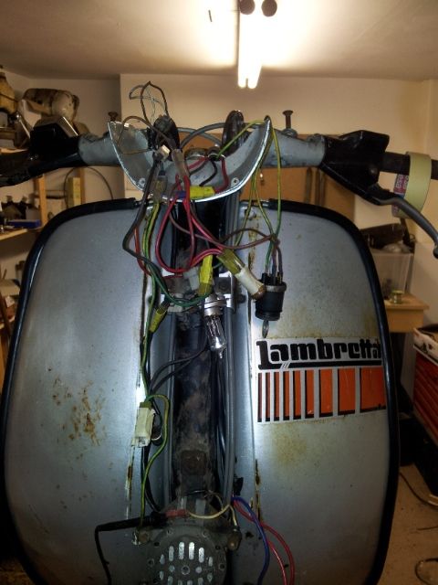

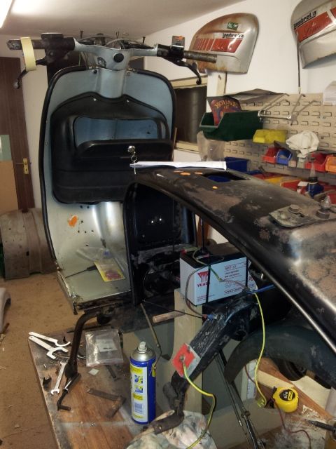

I rewarded my self a couple of day to work on it :) Got forks and headset stripped rebuilt and fitted, loom and cables fitted and a few more bits :)
The battery is there just to get the electrics sorted, and ive sorted them and it all works, well nearly, the switch is not working great, but i think i can fix that :)
The engines holding me up at the moment. The motoplat flywheel is fecked :cry: but i still would like to use the original electrics, so im looking for a flywheel. If i cant find one ill have to use a new Indian type stator and flywheel, but if i do, i may as well change the grank to GP type.
Next job is to fit the rubber mats that ive cleaned up today.

Leave it as is,its too nice to coat in shiny paint, that bike came from holland to Ireland by the way , i missed out on buying it myself, i was the same i hated the look of these when they were new, but i quite like them these days , there something a bit different, best of luck with it, oh and i dont think an indian flywheel will work with a motoplat but im no expert, ive a standard sx crank in my rapido and 3k later all is well. :D but i probably just jinxed myself..

Is it electronic though ? With the six triangle shaped windows ?
