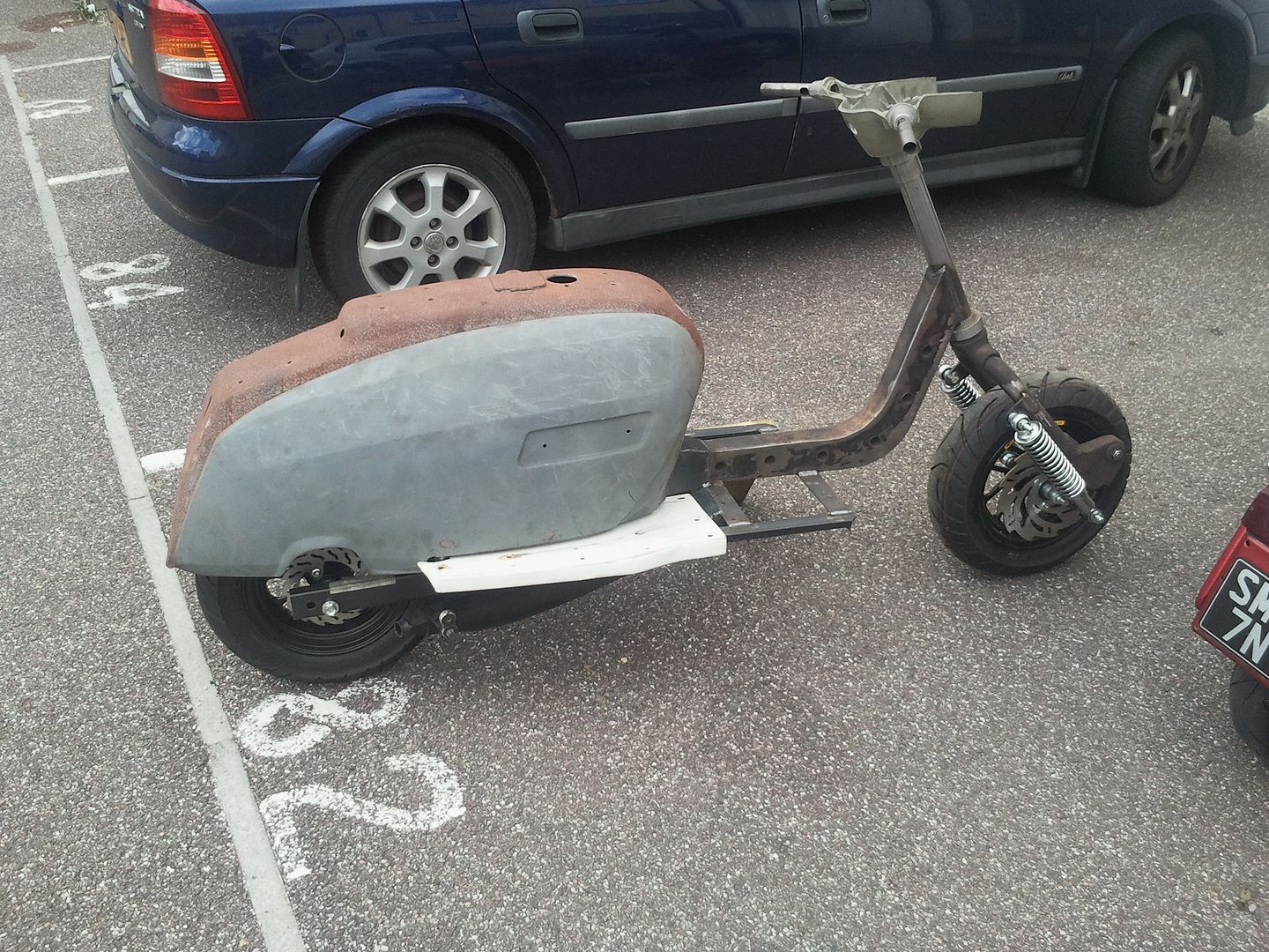

ok, so didn't get much done this weekend, wife working so had our daughter, and today was carnival day, so it seemed rude not to sit out in the harbour with a pint in hand watching the fun
I have fitted some front suspension, its way too stiff, but they were free and at least give me something to build around. 280mm eye to eye, so once I got the money I will buy some bitubo ones that will do the job properly
now all sat at its final ride height. rear suspension yet to be sorted.
this week I will get on the lathe, make all the spacers for suspension and wheels etc.
Cool !
btw did you use taper head bearings in the end ?

Yes. top and bottom. no point making all that myself and fitting rubbish old balls.
original basics of my design was that it should look fairly standard. but with modern running gear. hence disc brakes front and rear. taper race headstock bearings. modern electrics and lighting. Engine with electric start. trying to keep the italian thing going so brembo calipers and cagiva engine.
oh and all on a budget too lol. i still reckn that in a basic paintjob i can have it finished for less than 1000 quid.
