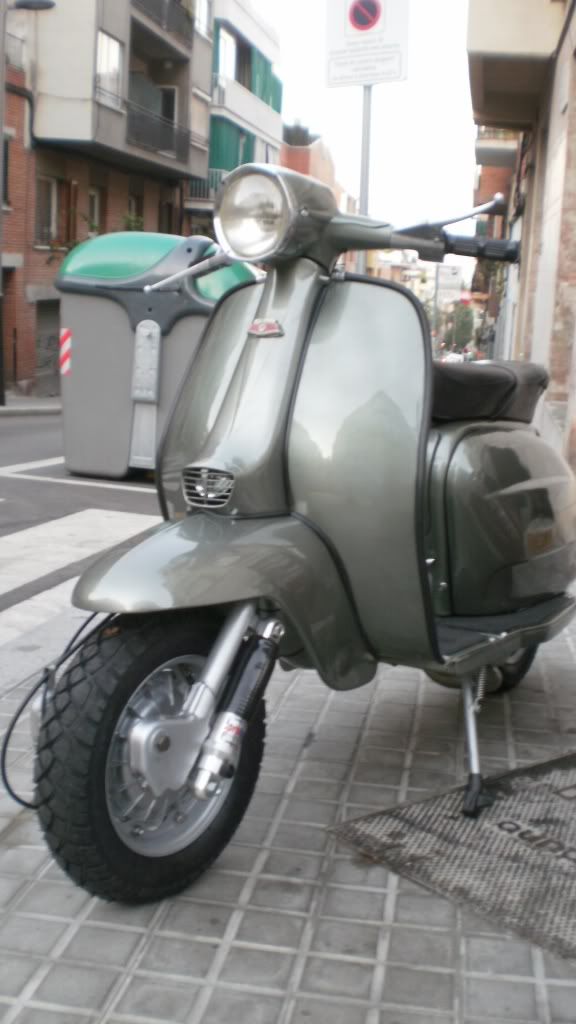

Jordan, to fit the protech you will need to file a bit of the lip that they have above the regulating wheel as they do knock against the fork stem. No big deal as it is only a couple of mm's but if you do so you will be straight to go. They are a bit stiff though, better for a person who weights over 100kgs, but they do look the part. This is how my mate Kepa's bike looks with them fitted:
Regards,
J.
