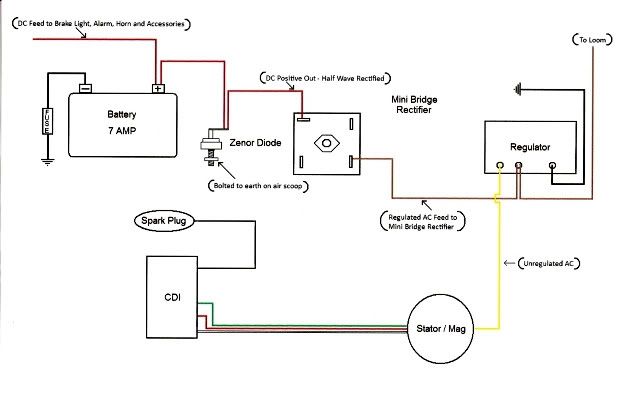

No, the AC switch can be used. The battery will not discharge through the reg/rec like the old AF DC system, so doesn't need isolating.Fantastic infomation, very helpful. Just a question, if this conversion to dc is done on an original ac machine does the ignition switch have to be changed to a dc one? Or can an ordinary switch be use to isolate the battery so it doesnt discharge
running pathfinders without battery
This is the schematic I promised...hope this is of some help and explains the way I wire my system and the mini bridge rectifier. This system does work and I have run it over the last 20 years on many scooters....With and without the Zenor fitted...

thanks J1MS, that's useful, I have got hold of a decent rating zenor diode [from a Rally], so will try this out, although so far my tacho is still working... so I might leave it for now and see to some more pressing jobs.J1MS wrote:This is the schematic I promised...
thanks J1MS!
wich bridge rectifier can i use?
JIMS, why did you go for this conversion over the vespa B+ regulator as your using more components to get the same result? Also the addition of one wire will give a full DC system, again wth less components.
