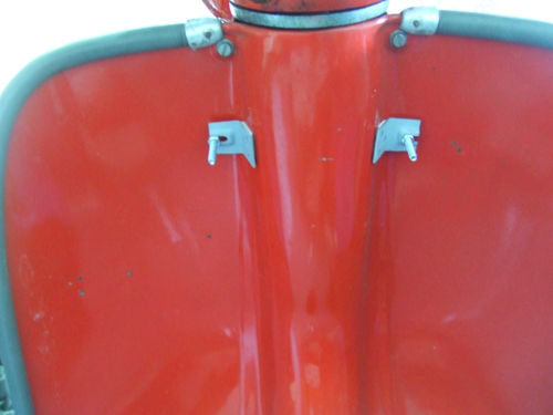

this is how they are fixed using the brackets provided (two only)
the brackets are rivetted (if already painted) or welded (if not) to the legshields for the upper fixings
the lower fixings should go straight through the legshields/mudguard
hope this is self explanatory
gaz

gaz_powell wrote:this is how they are fixed using the brackets provided (two only)
gaz
cheers gaz a picture is worth a thousand words
