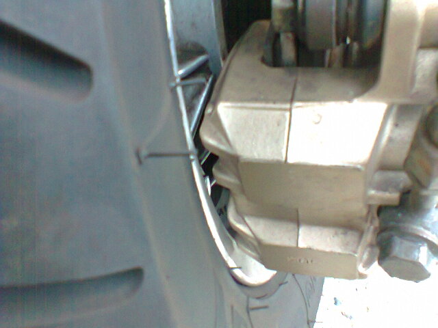

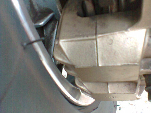

Mel K
Sorry the pic isn't closer

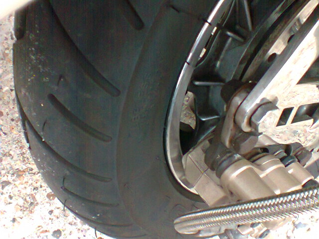

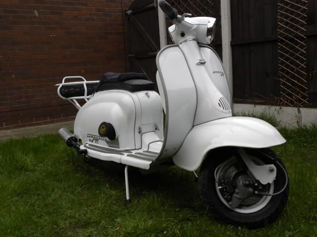

rbgaz
Posts: 539
pic of disc, o an pic of me scoot as ive never been able to do pics on here before 8-)
