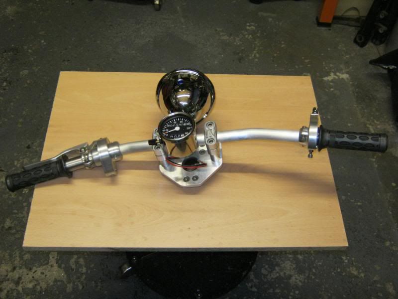

ok ..so if you dont want to use the beedspeed type then you can either make a top plate to take bar clamps allowing you to use ace type bars (or ape hangers if you so wished :lol: ) ,ld clamp ...again allowing the use of bike bars and also the bmx threadless type bar stem .. yet again ... yes you guessed it .. bike bars .. :lol:

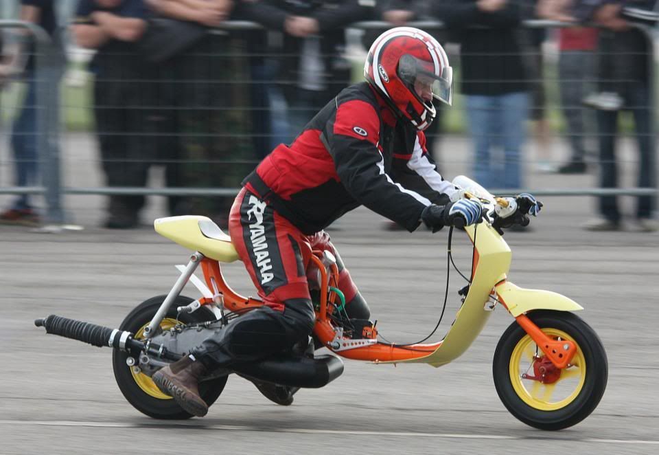

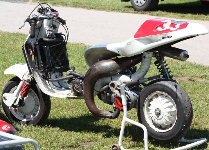

ill see what pics i have ...

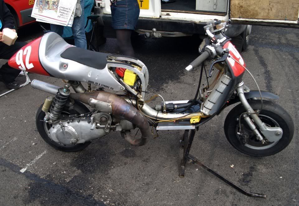

mine ;)

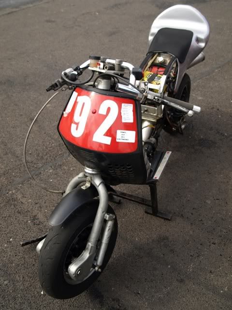

plate and bar clamps
