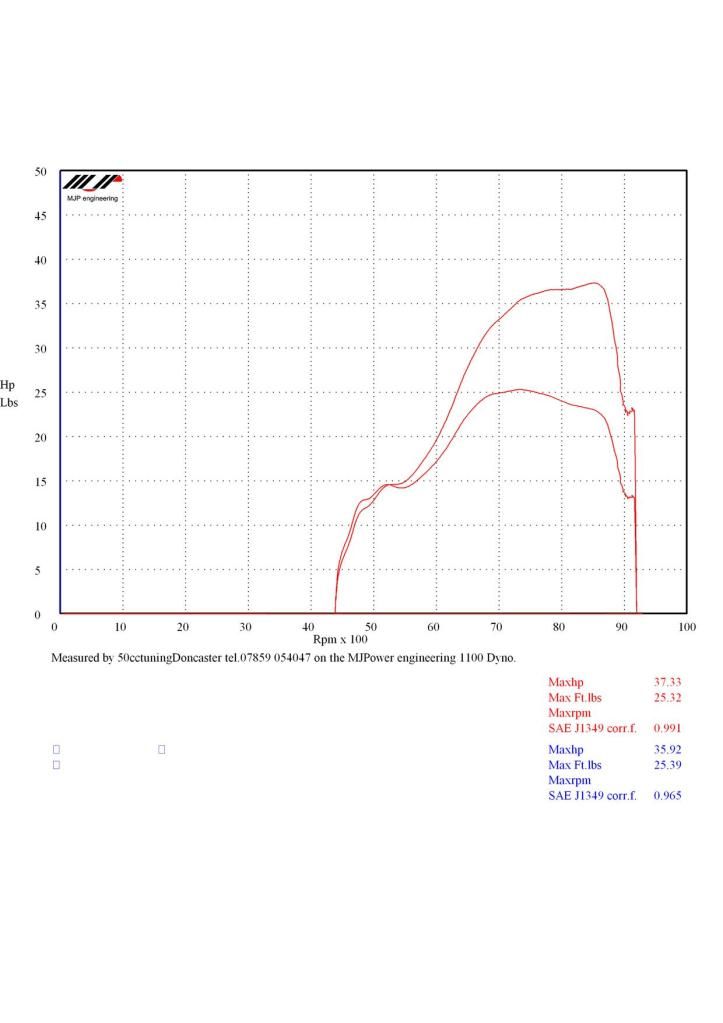

Darrell Taylor
Posts: 752
Main scooter: LAMBRETTA
Location: Doncaster
cylinder now back from replate with a bit of welding up to the ex port
with a few miles on it doing the scarborough/whitby run was now time to dyno and check out its final results
a dyno run showed its width of peak power to be improved
and the lambda showed it to be running richer at 12-1 so could have leaned off for more peak but thought better and left as is
