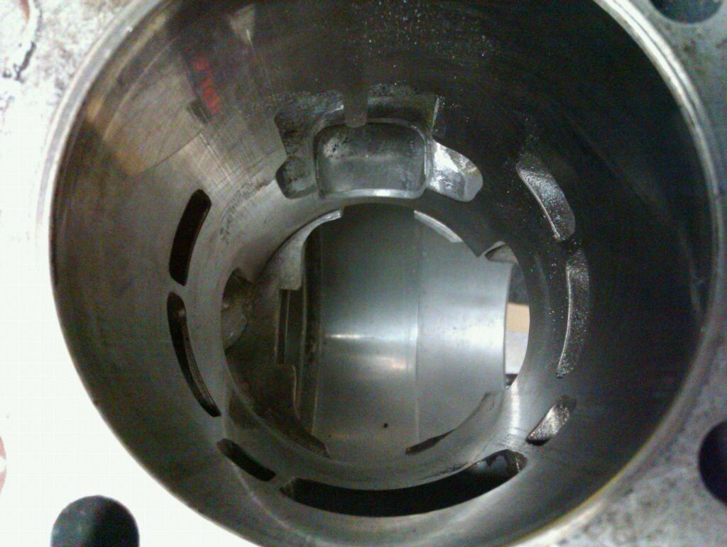

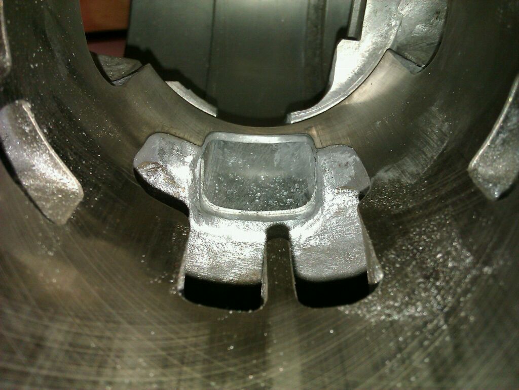

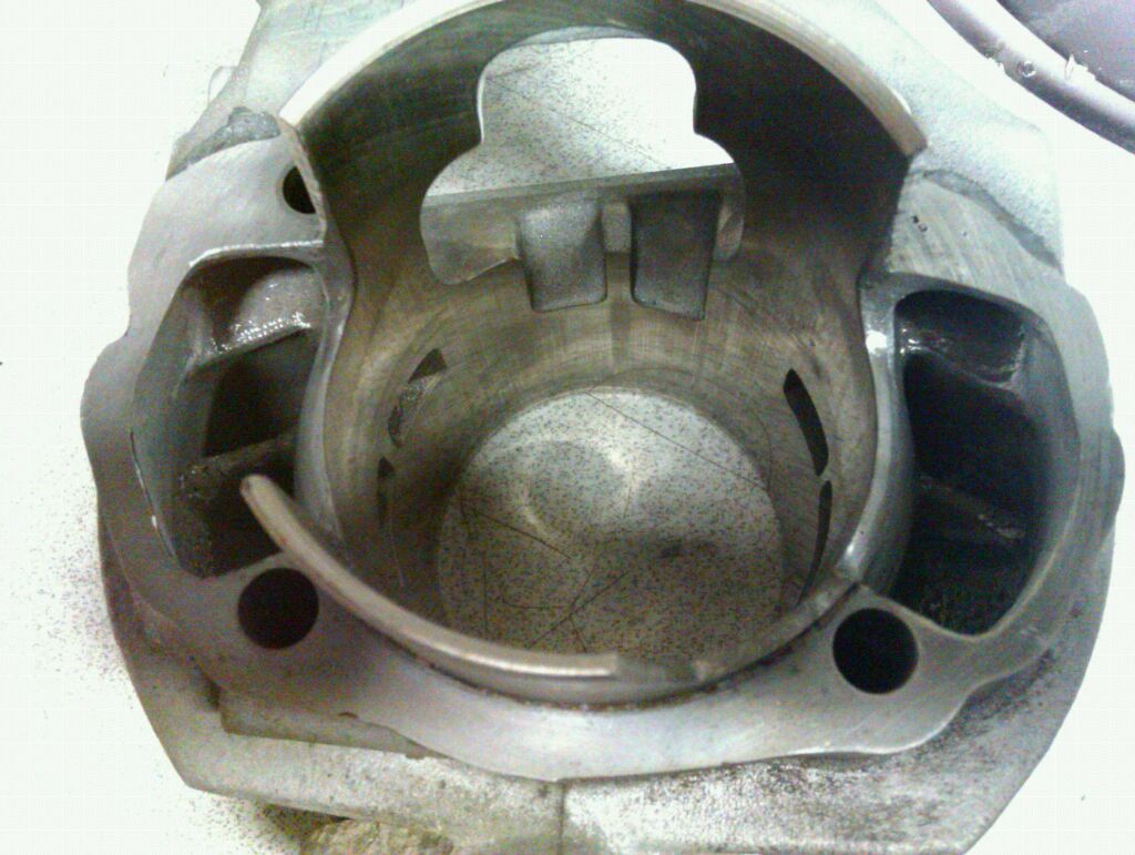

The new boost port, and enlarged transfers (exhaust side):
The new boost port, and enlarged transfers (boost side):
You should be able to see from the above pics that we've managed to get quite a bit of extra area on the secondary transfers, on the larger stud spacing side the secondary transfers and nearly as big as the main ones. And on the closer stud space side we made up the difference with the extra boost port (a la RB)

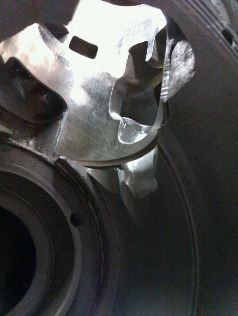

Since were talking about case mods heres one Im doing at the mo for Tesco pete
Ive done a few more Lamy cases with some different case porting like the two bike ones shown above
Ill have to take some photos when i get time maybe ;)
Heres one in progress
Key thing here is getting the Bang with out welding :D
The sprinter engine is underway, welded casings and kit, with big transfers. Other than starting the work to the inlet and 3rd transfer port, haven't started any other porting on exhaust or cylinder wall transfers etc. Anyway, it started....
