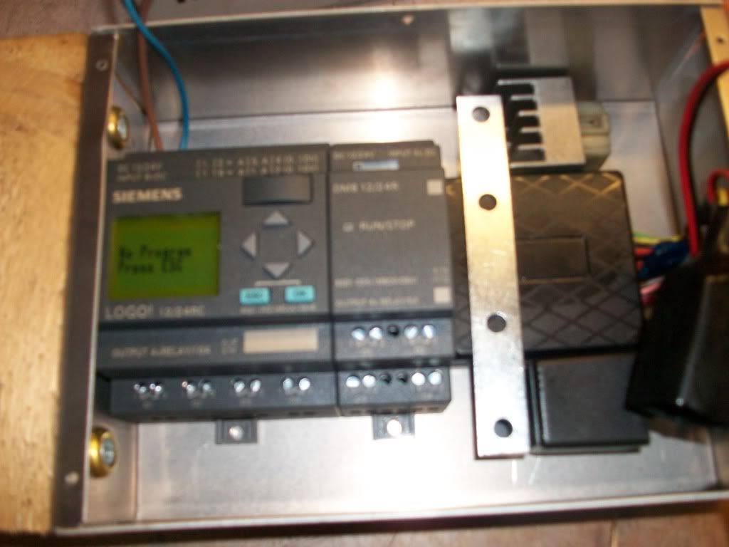

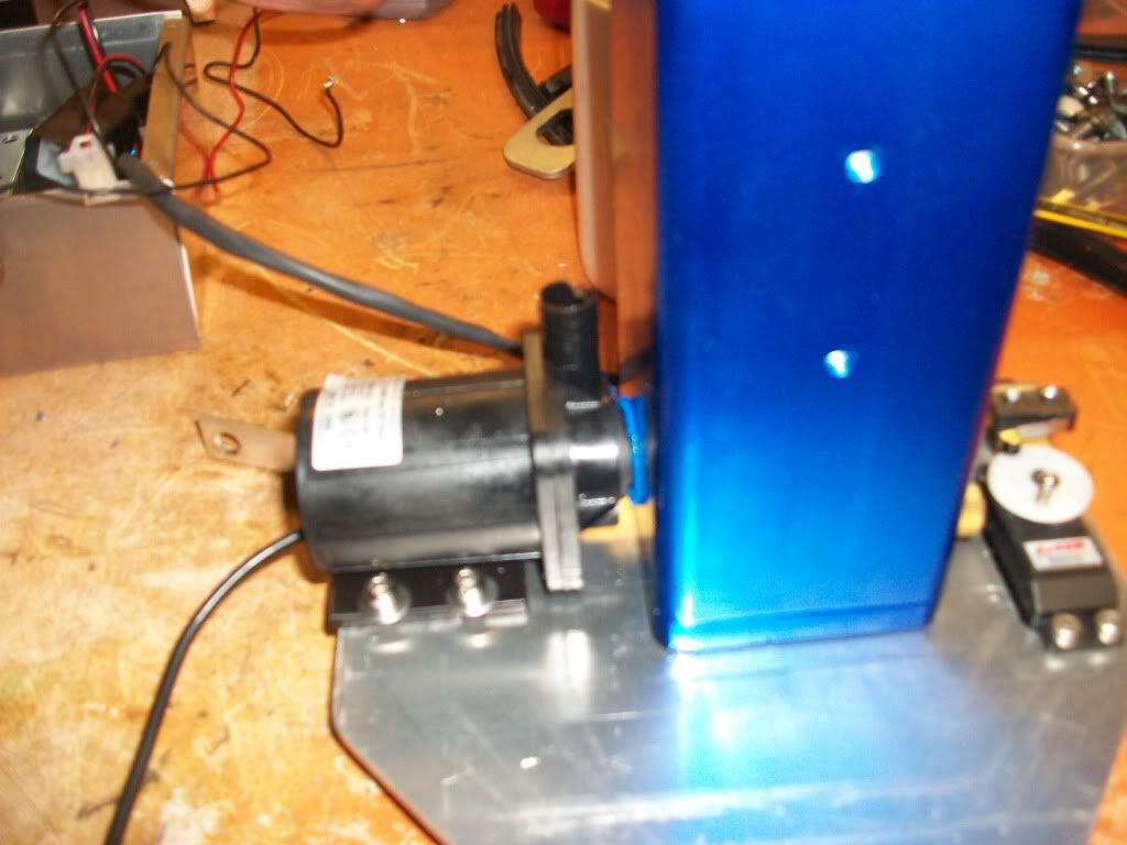

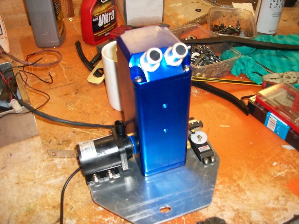

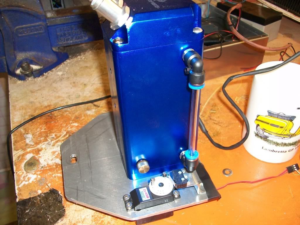

bit more done .the plc is going to get a input from a remote key fob (alarm) to turn on my digital speedo .digital taco ,volt meter it will also turn on servo choke which will turn off after a set time . the blue tank is for two stroke oil the small black pump will pump it direct into the petrol tank which is also ran buy the plc 10sec pump time is 100ml of oil . ill also have other input/outputs to tell me choke/pump is on

CANbus
Posts: 185
Great to see your giving a controller a go, if you haven't already done so,remember to give some thought to the isolation of the unit from the vibration,Nice one.

Hi ,will an electric pump on oil work ? If your stood still it will pump oil every ten seconds and when ur on full throttle you will be running lean , isnt thats why there gear driven to pump at the rate the engines spinning ? Love the choke idea though !
rocho68 wrote:Hi ,will an electric pump on oil work ? If your stood still it will pump oil every ten seconds and when ur on full throttle you will be running lean , isnt thats why there gear driven to pump at the rate the engines spinning ? Love the choke idea though !
I think you'll find it's to pump the required amount of oil into the tank when filling up to safe faffing about with bottles and jugs, not oil injection.
All very trick stuff but just a thought, won't the viscosity of the oil alter with temperature and thus affect the amount delivered in any given time? Maybe a flow meter might be needed?
